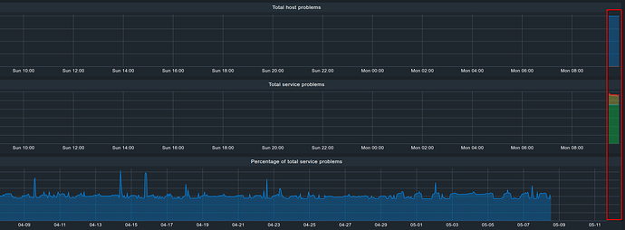

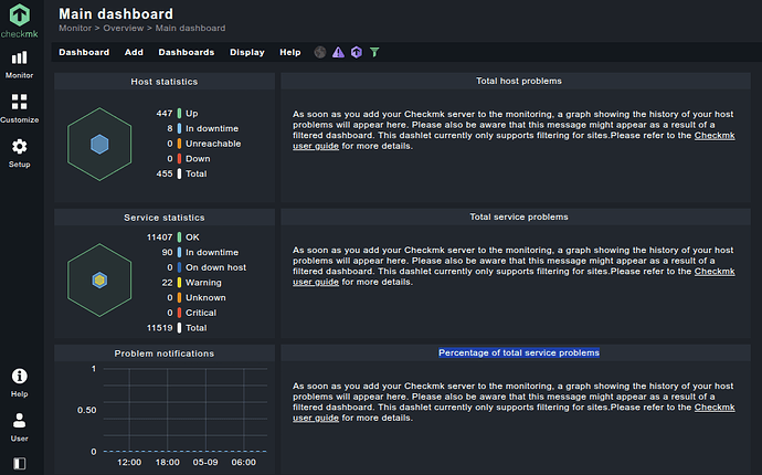

Shortly after the upgrade to 2.4.0 the three graphs:
  • Total host problems
  • Total service problems
  • Percentage of total service problems
went missing and show no data anymore:
The machine has the host label cmk/check_mk_server:yes still correctly assigned and detected, the agent is running on the server.

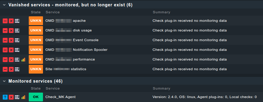

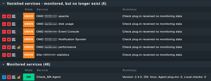

There are indeed a few checks missing, just like @ampfinger mentioned below there’s just the “omd status” left:
Not sure how you can install the agent to “not work 100%” like also mentioned below.

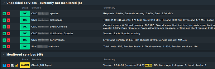

If I downgrade to a 2.3.0 agent:
# apt install /root/check-mk-agent_2.3.0p31-1_all.deb
The checks reappear:
And as soon as I upgrade to a 2.4.0 agent:
# apt install /root/check-mk-agent_2.4.0-1_all.deb
They go missing again:
