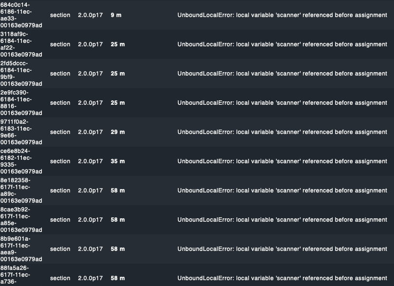

This is the report of the mentioned ID
Exception:
UnboundLocalError (local variable ‘scanner’ referenced before assignment)
Traceback:
File “/omd/sites/checkps/lib/python3/cmk/base/checkers/host_sections.py”, line 392, in _get_parsing_result
parsed_result = section.parse_function(data)
File “/omd/sites/checkps/local/lib/python3/cmk/base/plugins/agent_based/cve_2021_44228_log4j.py”, line 107, in parse_cve_2021_44228_log4j
scanner=scanner,
What also happens in the report overview:
