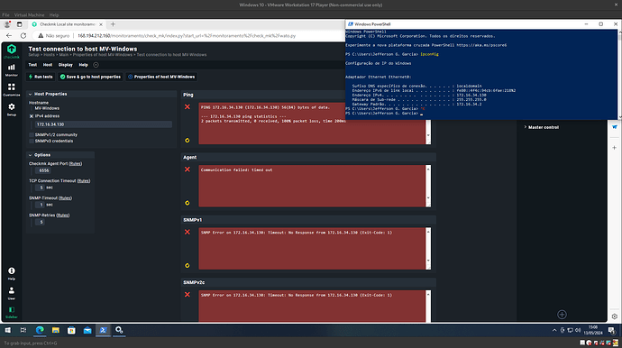

My question, for me to monitor a host, do I need a local server that will communicate with mine or can I get the agent to communicate directly with my central server, as I have clients from a business that only has two hosts for I monitor, in this case they don’t have a server on site, I needed to communicate directly with the checkmk server, but even releasing the ports on my router the agent is not communicating. In other words, I need an external host, outside of my network, to be able to communicate directly with my server, would I be able to do this?

168.194.212.160 seems to be a public IP address (please not share these if you can avoid id)
This means you need to allow your checkmk server on 168.194.212.160 to talk to your private 172.16.34.130 client.
I would strongly not recommend that. Opening your router for the outside world is a bad idea, and open all these ports you mention is not intelligent.
Best way would be to setup a VPN from the network you have your checkmk server to your local network.
