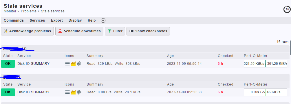

when i update from 2.2.0p9.cee to 2.2.0p30 ,all went correct.
but when i update from 2.2.0p30 to 2.3.0p9.cee.it show below disk-io-summary with stale status for windows server.,
could u plz suggest.
I think you need to update the installed agent on these machines.
