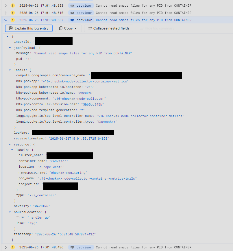

hi @martin.hirschvogel we also see error like this:
  "insertId": "",
  "jsonPayload": {
    "pid": "1",
    "message": "Cannot read smaps files for any PID from CONTAINER"
  "resource": {
    "type": "k8s_container",
    "labels": {
      "pod_name": "v16-checkmk-node-collector-container-metrics-tmz2s",
      "container_name": "cadvisor",
      "cluster_name": "",
      "location": "europe-west3",
      "project_id": "",
      "namespace_name": "checkmk-monitoring"
  "timestamp": "2025-06-26T15:01:48.587871743Z",
  "severity": "WARNING",
  "labels": {
    "logging.gke.io/top_level_controller_name": "v16-checkmk-node-collector-container-metrics",
    "k8s-pod/app_kubernetes_io/name": "checkmk",
    "k8s-pod/app": "v16-checkmk-node-collector-container-metrics",
    "k8s-pod/pod-template-generation": "2",
    "k8s-pod/app_kubernetes_io/instance": "v16",
    "compute.googleapis.com/resource_name": "",
    "logging.gke.io/top_level_controller_type": "DaemonSet",
    "k8s-pod/controller-revision-hash": "",
    "k8s-pod/component": "v16-checkmk-node-collector"
  "logName": "projects/logs/stderr",
  "sourceLocation": {
    "file": "handler.go",
    "line": "426"
  "receiveTimestamp": "2025-06-26T15:01:53.572510489Z"

The PID issue is not an issue. cAdvisor is just too verbose here.
