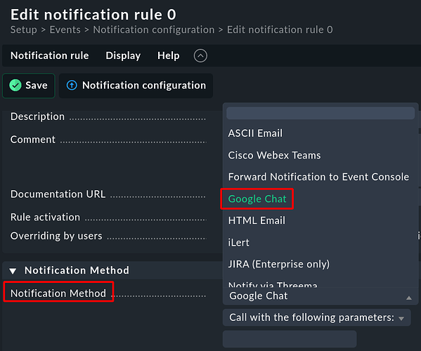

you can try these steps:
gchat_notify.sh
local/share/check_mk/notifications
# Google Chat
url and id to your needschmod +x gchat_notifiy.sh
After that you should get the new notification method for your notification rules:
Karl
Will not work as the script chat_notify.sh does not use environment variables but command line arguments to get the info about the alarm. It needs to be rewritten. That should be easy as it is a simple API call.
