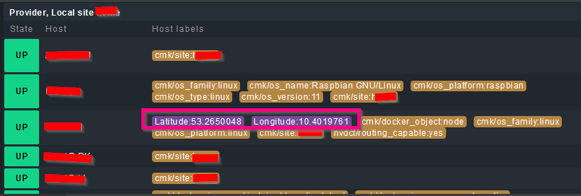

  3. Hosts must have latitude and longitude defined as host labels

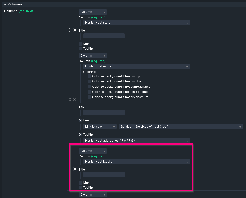

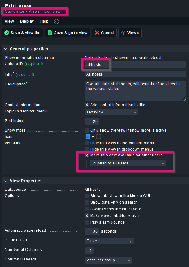

  1. A cloned “allhosts” view that is set to “public” and displays the above labels, preferably immediately after the host name. Reason: if you take this as the last column, Grafana does not manage to import it (apparently it is simply cut off after column 8 or i misconfigured something)

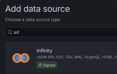

Log in to Grafana and install the Infinity Datasource:
Add datasource in Grafana:

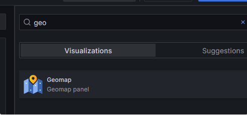

Name: Geomap (as you like)
Add visualization

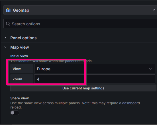

It’s best to limit the map a little right away, otherwise it will be too large:

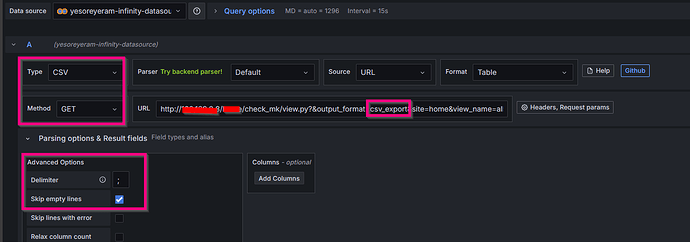

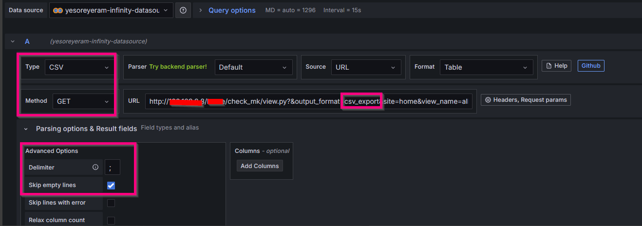

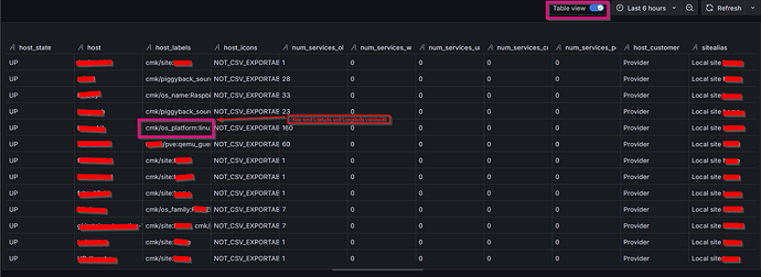

Configure datasource for visualization:
Type: CSV // Method: GET // Advanced Options: Delimiter: ; // Skip Empty Lines
URL according to the following model: http://check_mk/view.py?&output_format=csv_export&site=home&view_name=allhosts&_username=automation&_secret=********

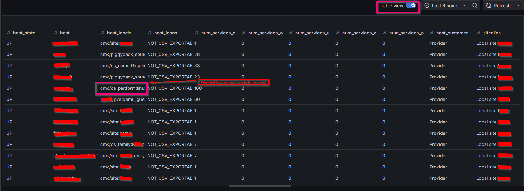

In the table view it should now look something like this (provider only exists here because cme):

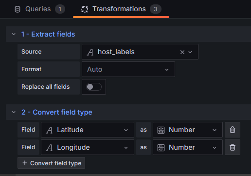

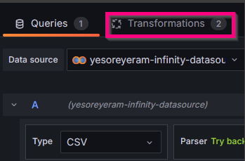

Add transformations

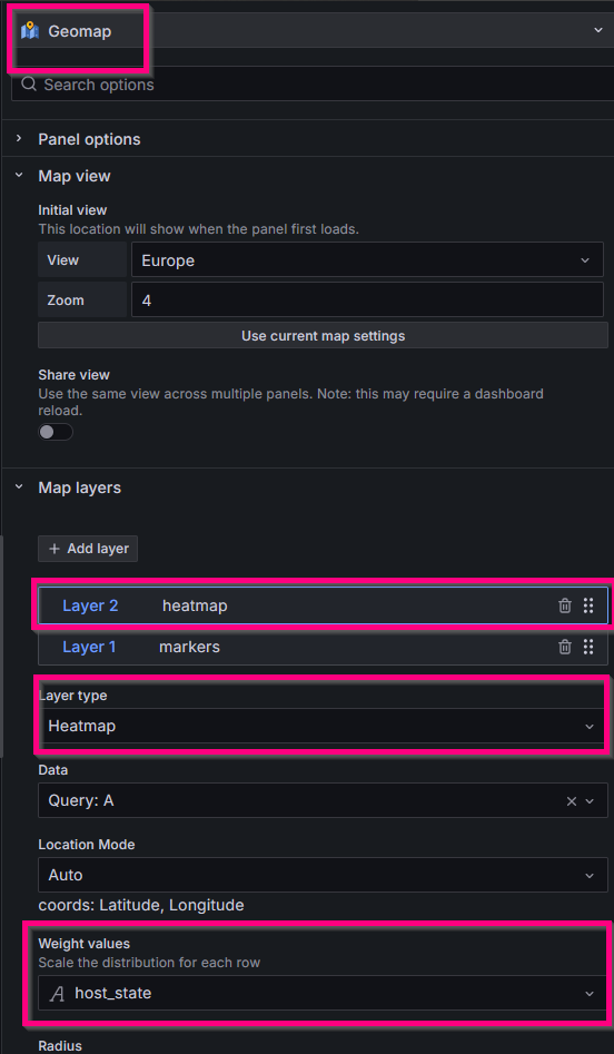

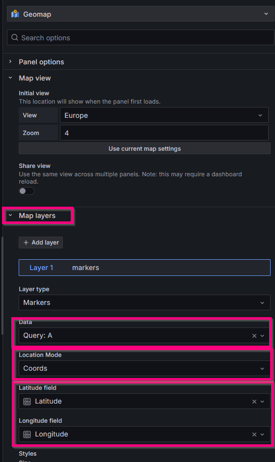

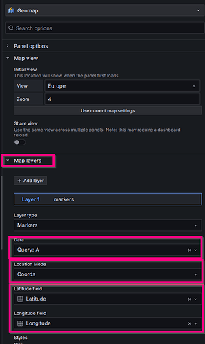

Now you can select the coordinates on the right-hand side under “Map Layers”

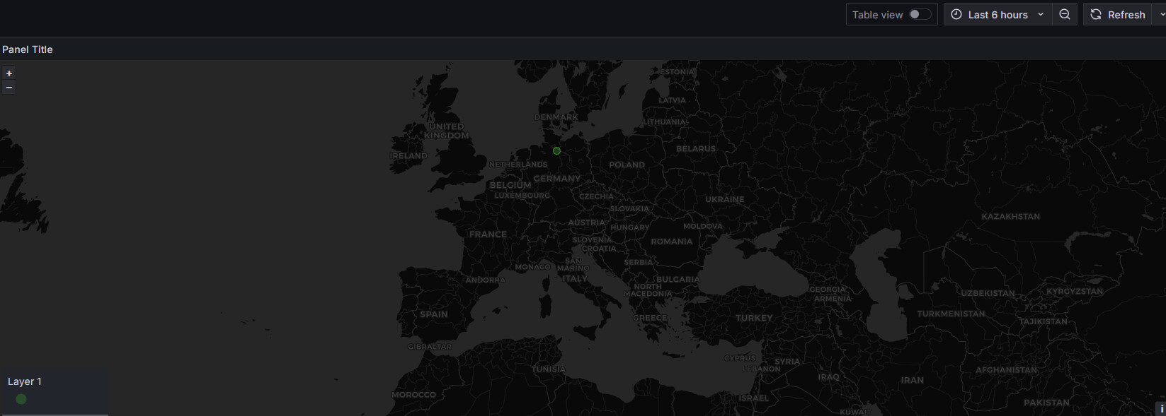

Profit:

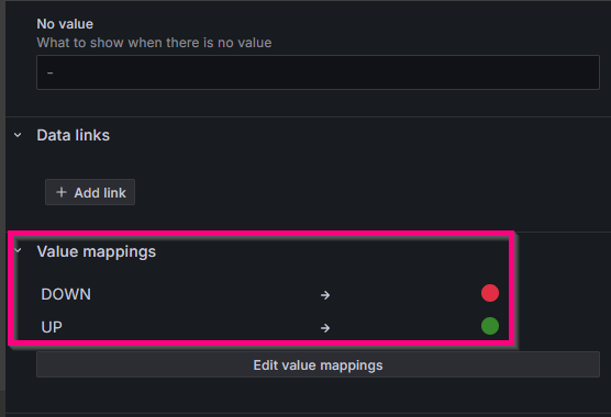

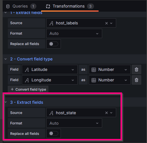

Add host status
  1. Add new transformation:

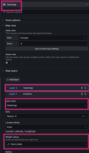

  1. Add new layer on the right:
  2. Scroll all the way down
