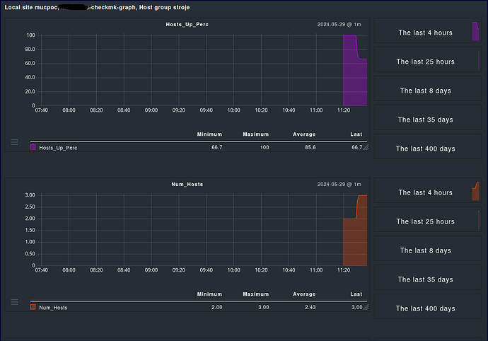

@Sara Can we move thread back to the Troubleshooting section? I think it’s not a problem with Checkmk documentation and particular example from docu as I stated before, but general with function check_levels itself. I will change Topic name so more people will have look (hopefuly) if it won’t be specified as problem with just docu.
No matter what I try, when using levels_lower Warning/Critical is just not drawn.

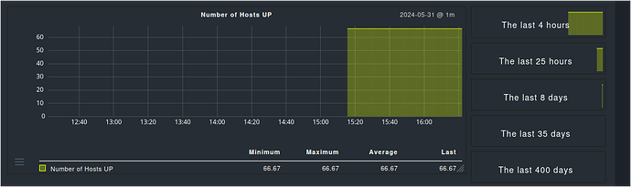

I think this is by design, with check_levels the warn/crit for the graph system comes from the upper_levels. And as there is no field for a second pair of warn/crit in the metrics definition you can not have both. see: Metrics in the Docs.
metricname=value;warn;crit;min;max

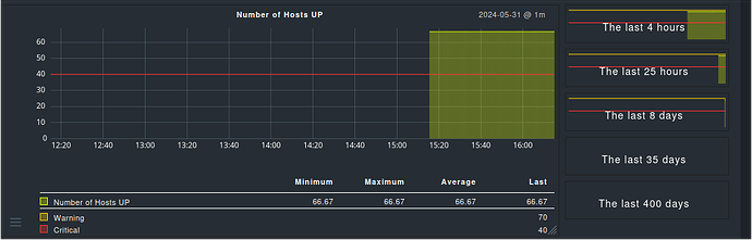

here a sample from one of my FW checks with upper and lower levels
as you can see the warn/crit is shown.
Here the rule for the levels
and a final look at the raw perfdata, there you also see the upper levels are used
if you want the lower levels in the metrics and still use check_levels you could do the check_levels with out metric_name and yield a separate metric.
