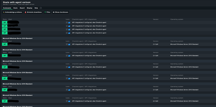

I’ve created a custom view dashboard. In this dashboard I’m using grouping functionality and picked Hosts: Inventory attribute: Operating system ➤ Operating system.
Now I see multple different tables with the same header, instead of multiple rows in the same header.
Why is this a problem? See screenshoot

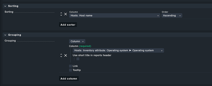

Thanks for the reply. Sorting is enabled. See options below

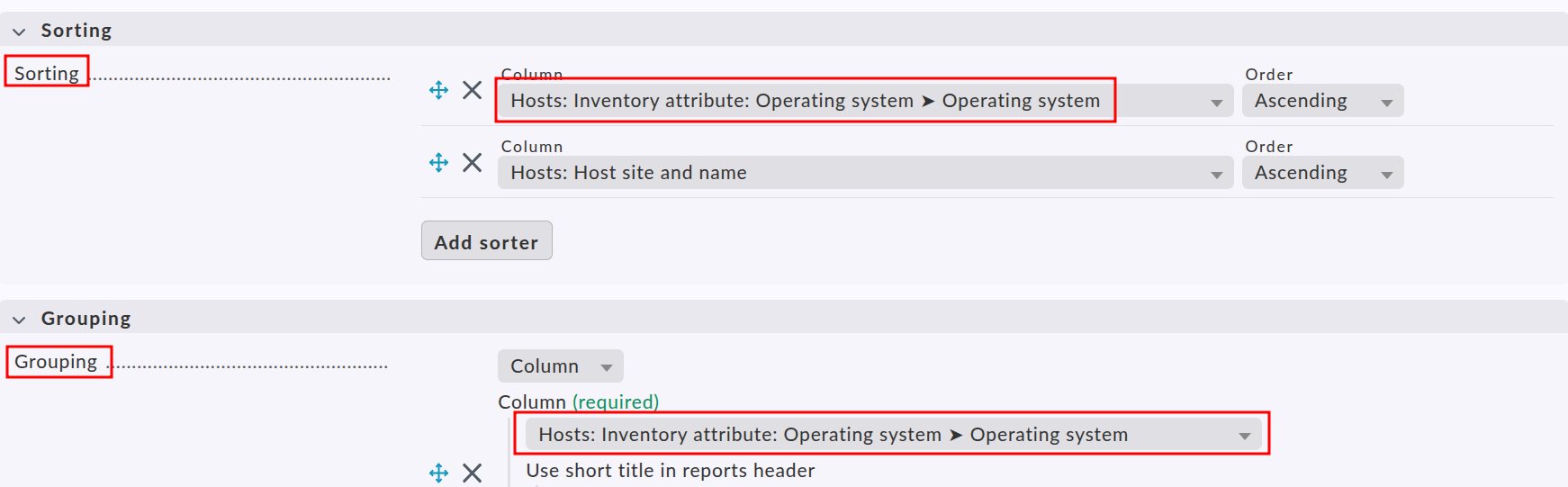

Hi @mike123,
try this:
Karl

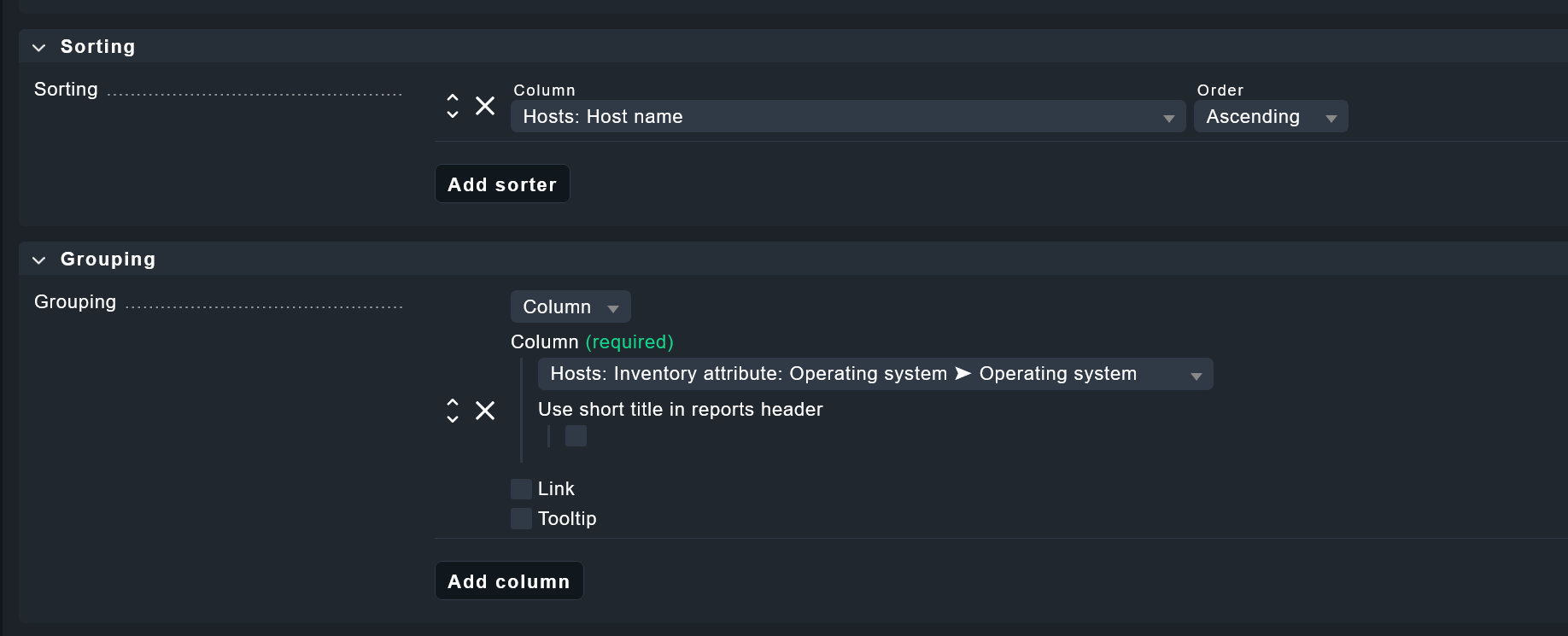

@kdeutsch the suggestion did not work.
It’s a bug or no?
