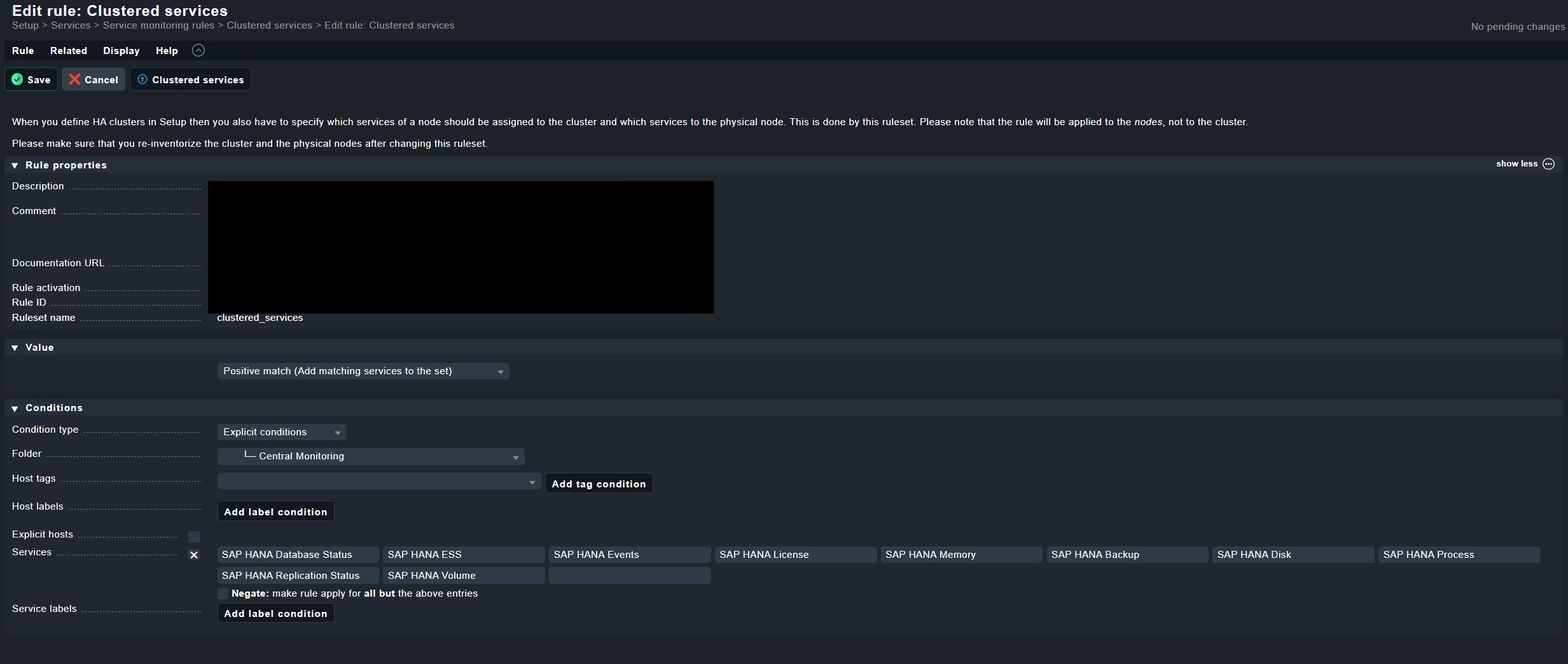

Basically you need a rule ‘Clustered Services’ and add all services except the SAP HANA instance Status to this rule:
Then create the cluster host with ‘Add cluster’ and add your both nodes to the Nodes of this object. In Discovered Service the SAP HANA services should appear on the cluster host object and they disappear on the nodes.

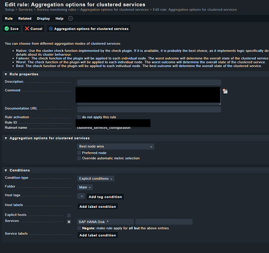

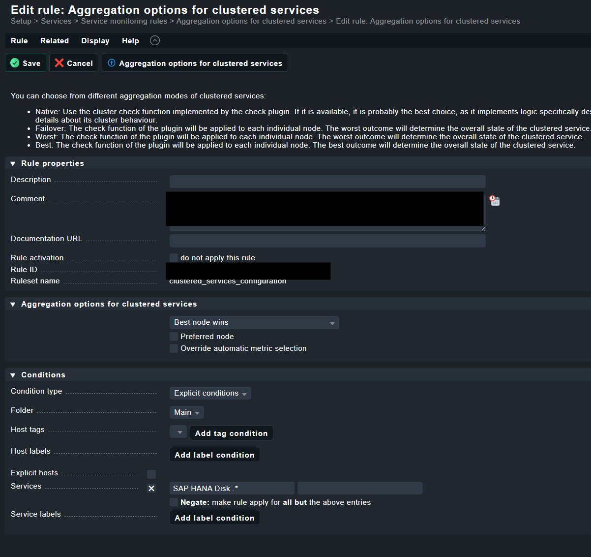

Hi Mike, please can you share the full screenshot of the rule you shared above? You can cross out identifiable hostnames etc. I don’t see how you got “Host tag: Database is SAP HANA” if I attempt to add a ”Clustered services” rule. Thank you.

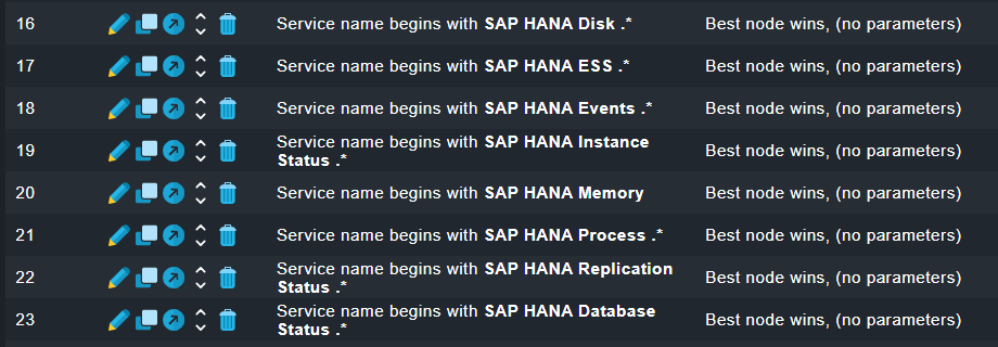

Basically you need this for all the clustered services to define the behavior
And the clustered service rule to add the service to the cluster object:
In case you run active DB´s on both cluster nodes use ‘Clustered services for overlapping clusters’ instead.
