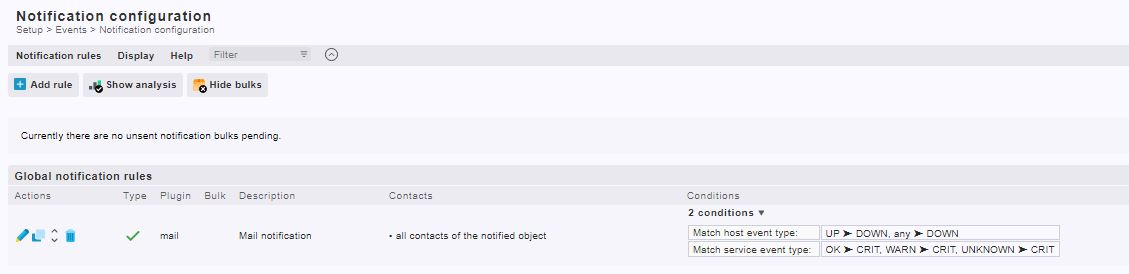

Hi Rojy,
are you looking for this?
That can be found in the “Setup” Menu, pretty far down (at least on my screen)
Or are you looking for ONE SPECIFIC RULE you created?

But till now my issue not resolved. I try with the images option you shared with me and cross checked my settings. And from my side i try to delete and re-configure global notification settings (Setup>Events>Notification configuration) but now also in null mailer service showing only three mail id that am already shared with you yesterday. This issue causes all notification mails are going to those mail id’s and in my mail ID and Another user cant get their notification. Am attaching images for your reference.

@itrojy Could there be a fallback email address configured that is receiving these mails? You should see if this setting is configured under Setup → General → Global Settings → Notifications → Fallback email address for notifications.
Or maybe there are some user-specific notification-rules that match these events. You should see these when you start from the first screenshot from @elias.voelker and click on “Display” and then “Display user rules”.
You could also check the notification-logs on the commandline, there you can see which notification-rule triggers the mail being sent. As the site user, take a look at the logfile ~/var/log/notify.log, this should give you a hint on which rules match.

We have already configured a valid Email Address in the user profile, and a total of 29 user with valid email address is created, but the mail is receiving for only in 3 mail ID. Screen shot is attached.
In the first attachment it is showing that no rule is configured (Highlighted in Green).

Okay, so the logfile explains pretty much everything that is going on:
  • The rule you configured does not match for the events and it probably does not match for most events. My guess is that either the conditions are too narrow or the contacts for the host are not set. Please check the contact groups for your host. If a host is not part of a contact group it won’t trigger the notification rule you configured. You can also verify this by asking one of your users to log in and check if the see the host.
  • As you can see it says “notifying fallback contacts” - some of your users have the setting “Receive fallback notifications” set. These are probably the three users that still receive the notifications. Check for your users if they have this setting in their profile. You will find this unter Setup → Users → then edit the properties of the user and you will find the setting under “Notifications”

Today i am notice that in “Global Notification Rule” earlier i am deleted one rule that updated in the starting time of CMK that causes the confusion/issue. For confirming i try same settings as earlier on the Global Notification Rule,after that am got notification again as same on yesterday without any change and i changed some settings i want in same “Global Notification Rule” as you said earlier. then i got my notification to all Hosts attached mail ID (27 mail id’s). It means if by mistake any one deleting “Global Notification Rule” then the old settings will persist there and we want to make “Global Notification” again to cover older settings if we are rebooted our server or reinstalled null-mailer client.
But now the issue if mail is sending by CMK, then all mail ID’s are getting notified. But i want the notification for assigned host mail ID only. Also if CMK trying to sent mail in mail log showing some SMTP error. Images attached
ISSUE RESOLVED !!! Thank you all to try to help me.
Because of my mistake i mentioned earlier i got stuck with email notification. Lots of search in all avalible communites and in CMK also i found that … If we are deleted the default notification settings from SETUP -->EVENTS–>NOTIFICATION RULES then we will stuck with old settings that we done. So we want to create same default notification rule again and change the settings one by one.
