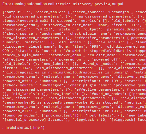

The error is when I do a service discovery:
Well, this is the definition of the rule:

There is a syntax error somewhere, according to the error message the error is in line 1.
Since this is unfortunately not your complete script, it is not possible to see exactly where the error is.
You should check your syntax and maybe run a linter.
Hi!
I found the problem, it should be written as State(params[‘parameter_name’])
