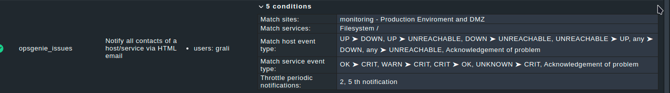

I have this
but it only sends the filesystem critical, not host down or unreachable :confused:
The “match services” filter (second from the top) means no host alerts can be matched by this rule.
So do i need separate alert rule for each alert type ? and what is the correct way to get the host alerts forwarded ? we have a rule for slack alerts that just includes everything and that works fine :confused:

Could this be the problem ?
does not match: The service’s description ‘Check_MK Discovery’ does not match by the list of allowed services (Filesystem /)
Depends. If you refer to the opsgenie rule as ‘prod and limbo db basic opsgenie alerts’, then there is a hostname mismatch.
No, that’s a different rule my colleague was testing.
The one I was talking about is the one with filesystem service check and what I thought was all host statuses going down or unreachable :thinking: but it seems host alert also needs a service ?
Clone that rule, the first rule you use for host notifications and select all the filters that you find useful while in the second one you use for service notifications and apply all filters that are useful for you.
