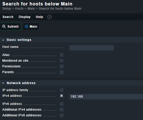

In the search menu:
Setup > Hosts > Main > Search for hosts
No results are shown when searching by IP address. I’ve tried different search methods, but none of them show any data. However, searching by IP address in QuickSearch works perfectly:
If you search this way, it will find only hosts that have the IP address explicitly set in the host configuration.

I understand. It only searches by full IP addresses, not by part of them like QuickSearch does.
Well, I find QuickSearch’s search method more interesting. Don’t you think?

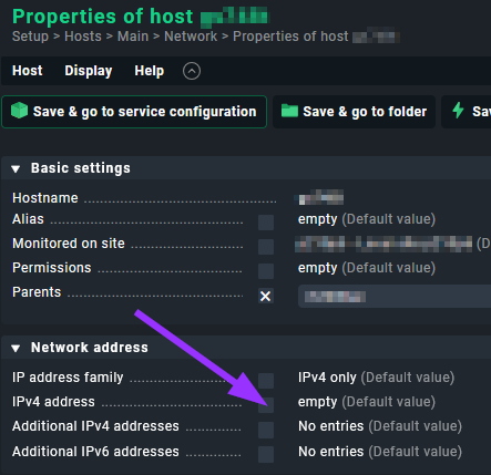

Even if you enter a full IP address, it won’t find that host if IP address isn’t explicity set in the host configuration. Like this example.
If it is set, then it can be found that way.
