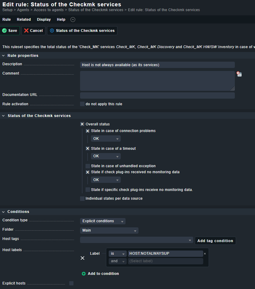

I have some hosts (VMs) that are not always up. Therefore I used the tag HOST:NOTALWAYSUP and the rule
That works very well, until I did a bulk service discovery.
After that all the hosts - that are down - are marked as CRIT.
Has anybody an idea, what has gone wrong and how I can fix it?

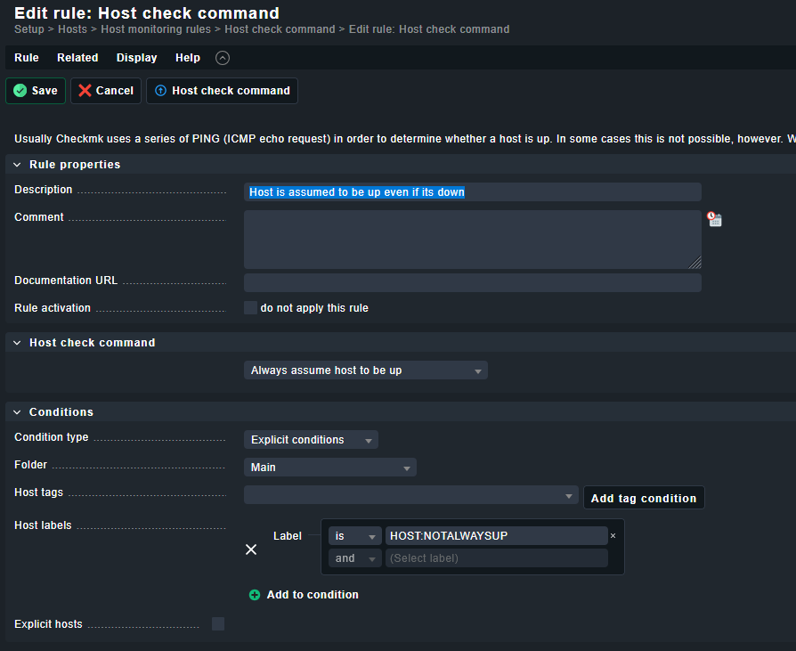

I could solve the problem.
I need to start the stopped VMs, rescan the services.
And I need to add a rule at
Setup -> Hosts -> Host monitoring rules -> Host check command
