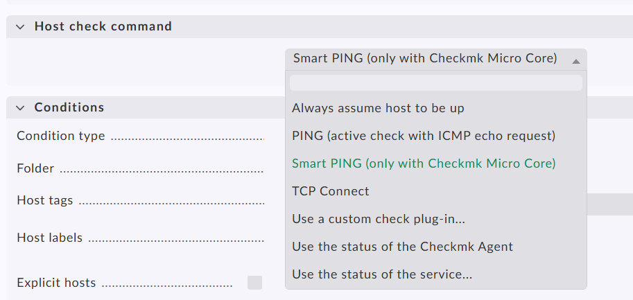

Then you need to switch the host check command for this host.
Thats the selection you have - in your case “PING (active check with ICMP echo request)” is the default selection. This uses the check_icmp command.
For the problem host you select “Use a custom check plug-in…”
At last you set the correct conditions and it should ping the host.
