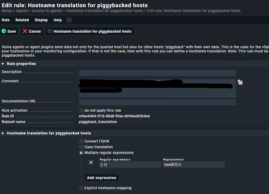

I want to create a “Hostname translation for piggyback” for my Docker Containers, that are created automatically.
Can I create a generic rule or do I need to create one for each host.
I read something about creating a rule like this, but not getting it to work.
Also, I would have preferred if I in replacement could use a dynamic hostname
