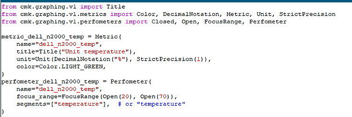

My graphing_dell_n2000_temp.py file is

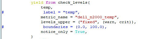

and I added the line to the check_levels call in the check’s file:

“segments=” has to be the name of the Metric, not the “name=”
segments=["dell_n2000_temp"],
Sorry, my fault!
thanks @MarcS !
You are right, the API documentation says: “A list of metric names or objects”.
Unfortunately it didn’t work. I have tried with
and
segments=["metric_dell_n2000_temp"],
but then the perfometer’s graph just vanishes.
The funny part is that only this shows the perfometer at all (with the not desired color, though, but better that then nothing), when it like this:
segments=["temperature"],
Pretty weird.
