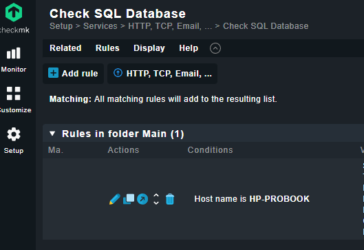

Hi, and thanks for your response…
no it’s the opposite I don’t want only “SQL Server ping master” that I found in every host that I create
In this host I haven’t installed the agent… I’ll do later…
ALEN
I resolved using an inclusion RULE…
Thanks
Ah, you had no condition in this rule and therefor the service check was configured on every host.
Yes, you’re right…
