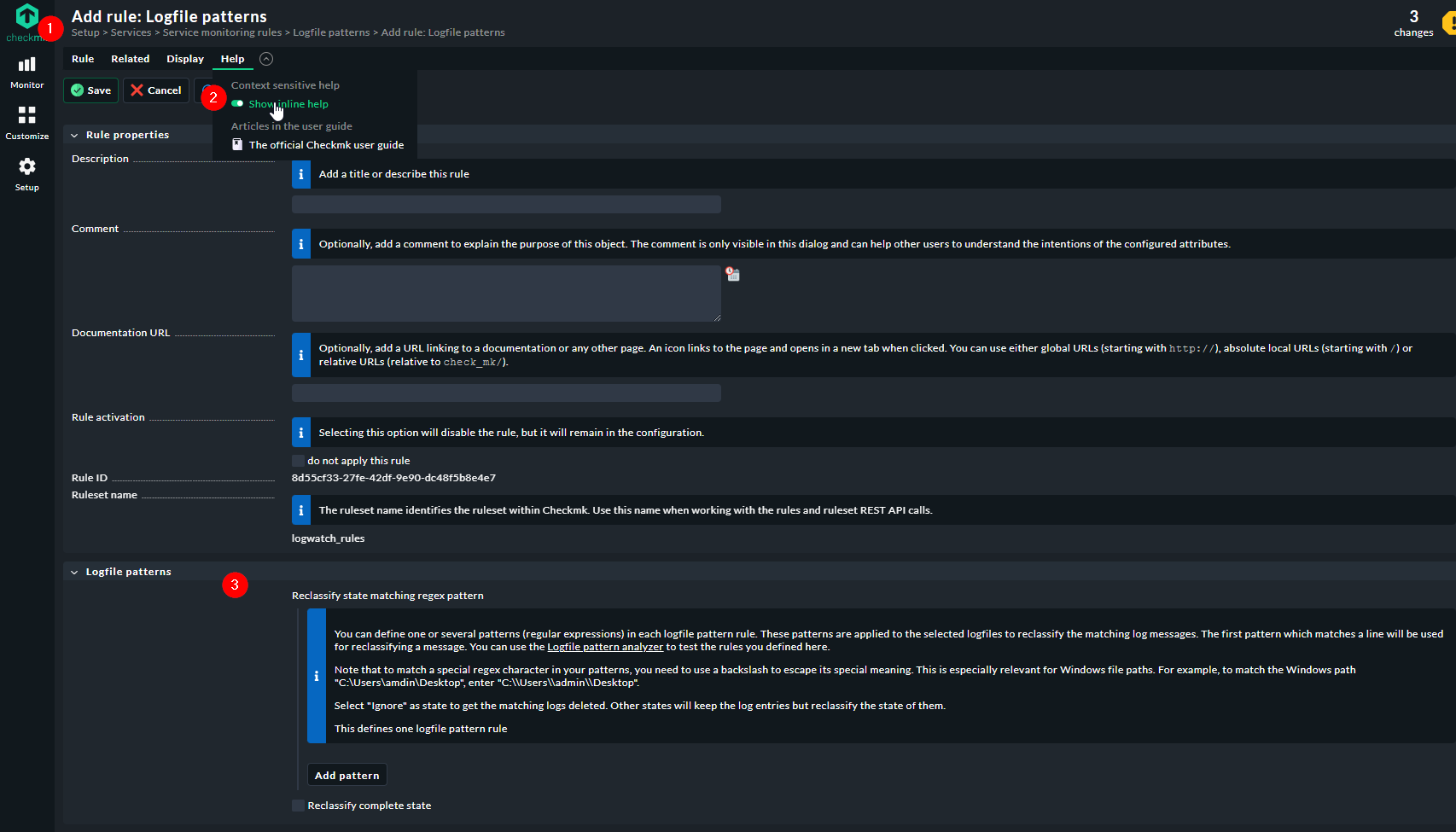

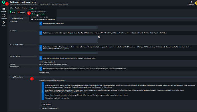

Hi Iain,
looks like the key section that would be important for you is still missing:
As the article mentions, there is the inline help for the service monitoring rule:
Yes, That’s what I have done. I have added 9 log file pattern rules and after the third one it stopped reclassifying the logs alerts for some reason.
