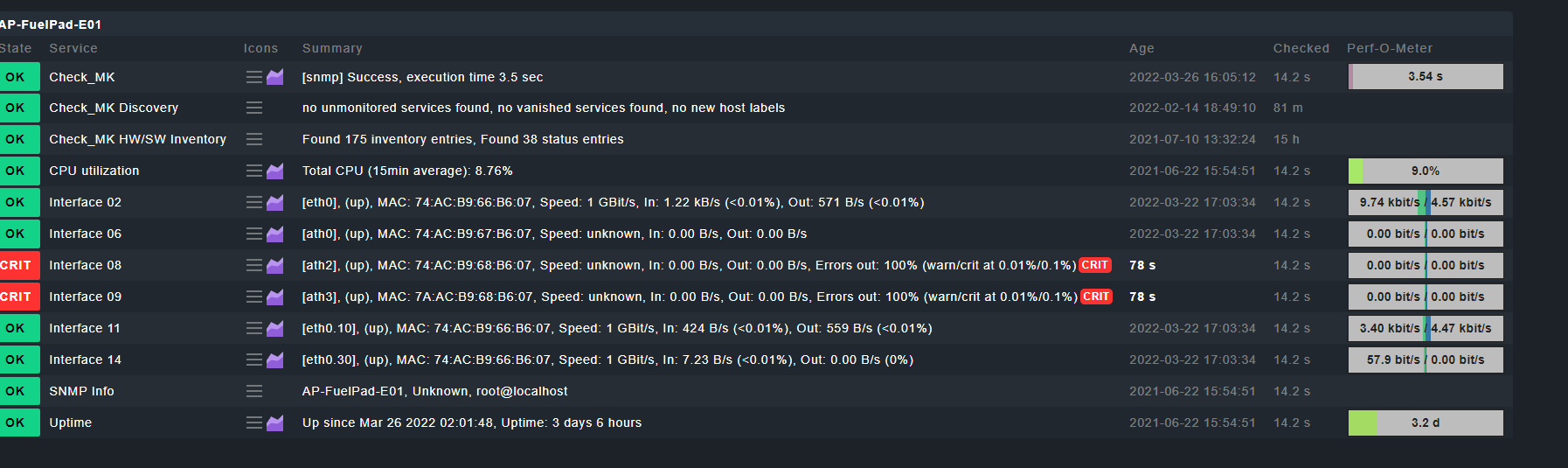

How do i resolve this error or prevent this monitoring
Well, I’d fix my network if I were you. It’s reporting and 100% error rate at packets out. I don’t know your setup but that can’t be good.
If you really want to ignore it you can create a rule for that.
Louis
the issues is there dont seem to be any error… how can i create a rule to ignore that?
Interesting, since the OS does seem to report the error. Or you’ve found a bug in CheckMK, which is of course also possible.

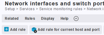

To create the rule you can try this. Click on the 3 horziontal stripes and choose “Parameters for this service”
Then click on "Network interfaces and switch ports:
Then click on the “Add rule for current host and port” button:
Then fill out something like this:
You may need to set the levels at 101% or so; I’ve never tried ignoring all errors on a network interface.
Safe and activate your changes and you should no longer see the error.
