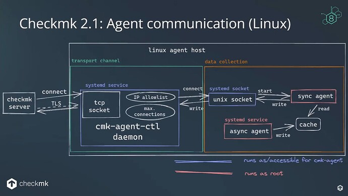

On systemd systems the dataflow is as follows:
  1. The systemd service cmk-agent-ctl-daemon.service listens on TCP port 6556 (by default).
  2. If that daemon decides to call the checkmk agent, it talks into the local unix domain socket /run/check-mk-agent.socket.
  3. That socket is controlled by the systemd socket unit check-mk-agent.socket.
  4. If something “happens” on that socket, systemd starts the service unit check-mk-agent@.service which then in turn runs the agent.
To change the listening port from 6556 to 16556 you must create (or edit) the file /var/lib/cmk-agent/cmk-agent-ctl.toml on the monitored host and add this line:
pull_port = 16556
After that, do a systemctl restart cmk-agent-ctl-daemon.service.
Unfortuntely, this is not documented very well.
Usually the file /var/lib/cmk-agent/cmk-agent-ctl.toml is maintained by the agent bakery.

You are welcome. Maybe this picture helps a bit understanding the data flow. It’s from the checkmk conference 2022 and shows the “new” communication.
To change the listening port we have to change the configuration of the “transport channel” on the left hand side of the slide, i.e. the configuration of the cmk-agent-ctl daemon. By default it listens on port 6556 and allows access from every IP address.
This can be changed with the file /var/lib/cmk-agent/cmk-agent-ctl.toml (in Python syntax):
pull_port = 16556
allowed_ip = [
    "127.0.0.1",
    "127.0.0.2",
(The file doesn’t exist by default.)
