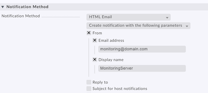

Hello team,
I’ve have been pulling my hair configuring notifications. i have set up postfix and now i can send emails. The problem is that when emails are sent from my checkmk server, it sets the from address as mysitename@hostname.local.
How can i override this information with the correct email address ? say cmk@mydomain.com
Thank you in advance
Inside the notification rules you can define your own from address.

Waaaaooouah !
So easy that want to cry :sweat_smile:.
Guess I had been searching the wrong place.
Thank you so much @andreas-doehler !!!
