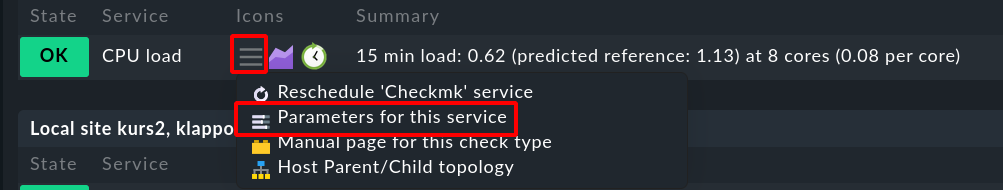

search for the service in Monitor. When you get the list with the service, open the action menu icon and click on paramters for this service.
You should see the rule, you have to setup. The screenshot you have posted shows the manual page - in this place it is not possible to change the levels.
Karl
Here you can read about checkmk’s rule based configuration: Host and service parameters - Understanding and using rules in Checkmk
