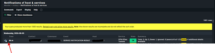

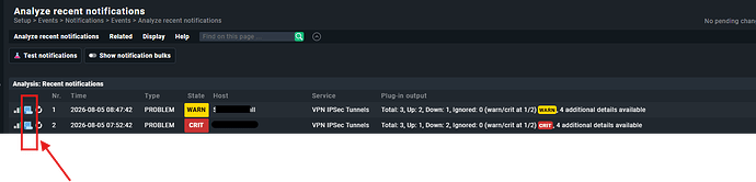

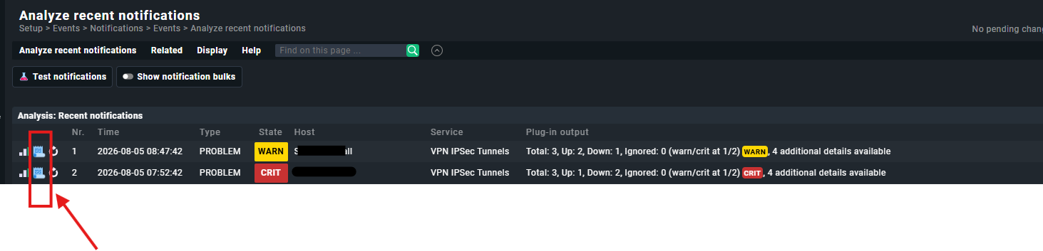

I am trying to review all the notification context for all the historical notification, but it seems the notification context only available for the recent 10 notification, there is no such notification context button under Notifications of host & Service, anyway i can find it ? Thanks.

– I dont’ think I specify such amount , I just check it from the recent notification analysis tab which only shows 10 alerts

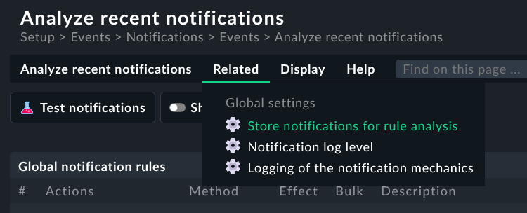

This is the default value. If you are inside your analyse notification view you can open the menu and configure this option.
See my first screenshot. There is also the option for the log level.
