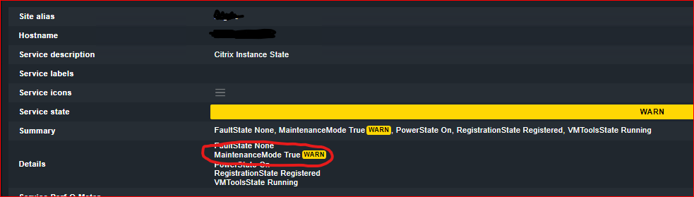

Using CMK EE 2.2.0p5, monitoring Citrix XenApp using citrix_farm.ps1, I am able to pull metrics without issues.

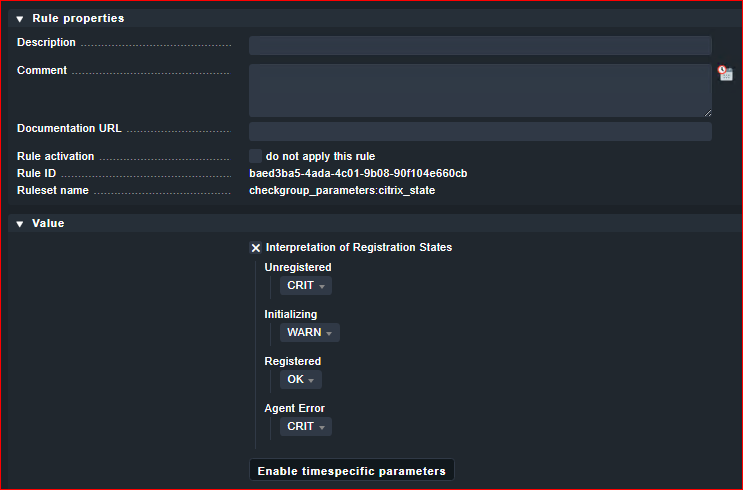

The issue is, using WATO it does not appear that all state conditions are configurable.
I have servers in the farm that are always in maintenance mode (standby), this means that the MaintenanceMode=True should not be a warning.
Other than ignoring this check type on these servers, is there a way to configure the check type to accept MaintenanceMode=True as an OK condition instead of WARN?

Last but not least, you could learn how to develop plugins and then edit the one shown in the screenshot above, so that you can decide upon the state of an enabled maintenance mode by defining a rule in the WATO UI.
I am aware that I can change the file, but if I make the check_citrix_state() it will affect all hosts, I only want this on a subset of hosts, hence it should be configurable via WATO.

Just to add to this, in case anyone else comes across, we can use “Service state translation” to re-map the WARN into OK for check_mk-citrix_state for specific hosts using WATO.
Yes, but be aware that this will happen with all WARN states this check can have. Not just the active maintenance mode. :slight_smile:
