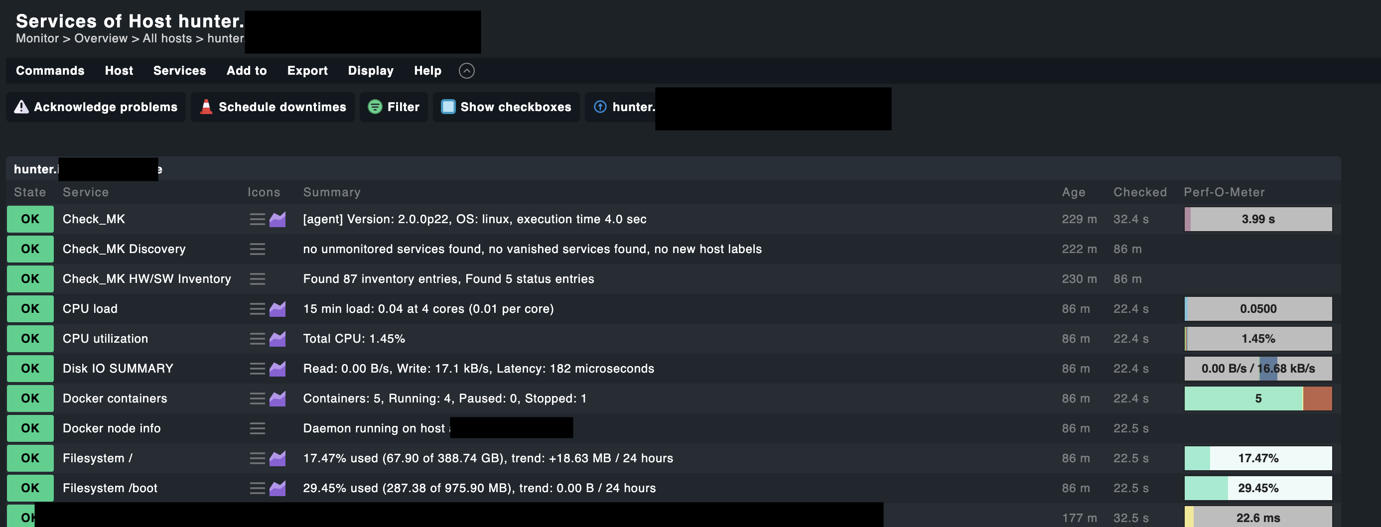

All services appeared, the Docker container status could be read:
Containers: 5, Running: 4, Paused: 0, Stopped: 1

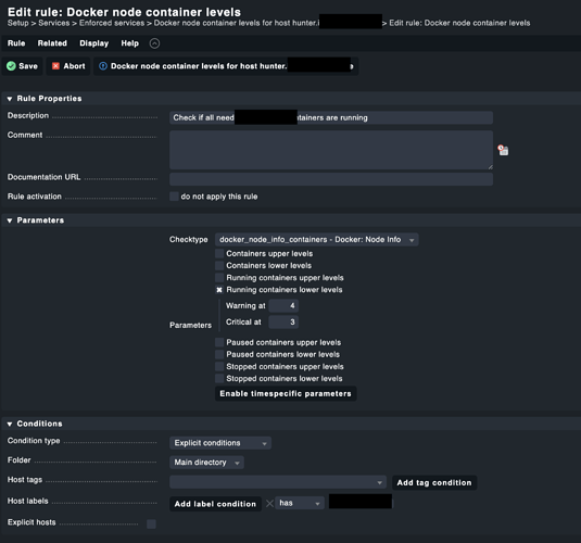

  1. Created a new Enforced Services rule for Docker node container levels
  2. Set the Running containers lower levels to Warning at 4, Critical at 3
  3. Adjusted the conditions to my needs
  4. Saved and activated the changes

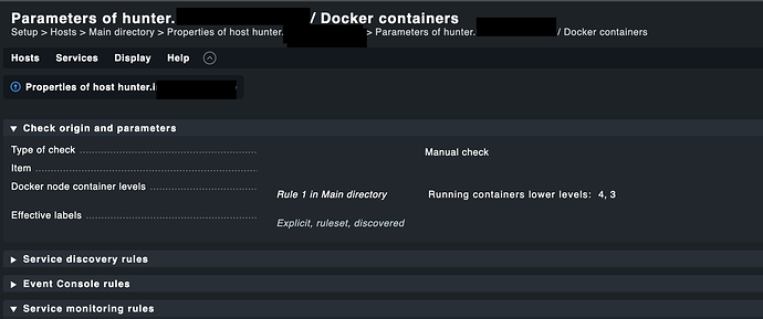

The rule is being applied for the host, I checked that. But the status does not change.
There is currently one container down. So it should switch to WARN.

Hi Ralf,
you can find some more infos in the screenshots below.
Screenshot
(Sorry, have to upload them separately.)

Here’s another screenshot:
Screenshot
And another:
Screenshot
with these settings it should go warning if there are less then 4 running conainers and critical if there are less than 3 running containers.
Just play with the numbers und look at the result. Or stop another container.
The way you set it up is correct.

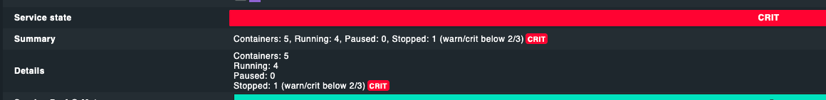

Okay, nevermind. I got it to work!
The service details of my last screenshot brought me on the right path. It says “warn/crit below 1/2”.
I’ve changed everything to “Stopped containers upper levels: 1, 2” and its working correctly now.
