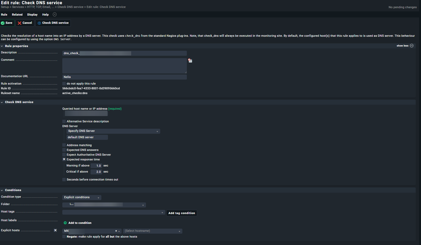

We are monitoring some office 365 MX records within check mk, the goal is to monitor the response times. The problem is that check mk can’t ping the office 365 MX records.
So I can up with the idea to configure the “IP Adress family” with “NO IP” and that works fine.
The only problem is that on the “activate pending changes” page a lot of warnings are visible from all these hosts.
How can I get rid of these warnings?
All these hosts are configured with only a hostname and these 4 settings.
Beside that we also configured the “check DNS service” rules and are linked to the relevant host.
The setting “Queried host name or IP Adress” is the office 365 MX record
The “folder” is configured where the host in located
The “explicit hosts” is the host where the DNS check is created.
