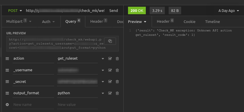

I tried, but old installations like mine (1.4p36) doesn’t support this kind of requests to their API:

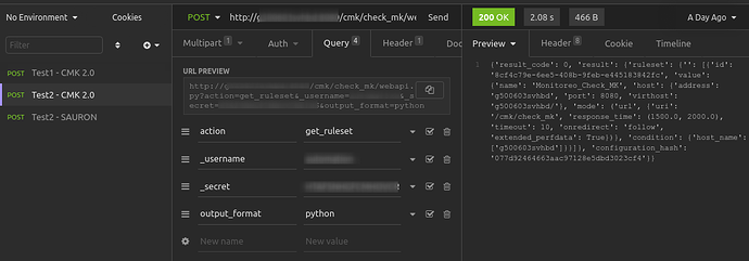

Witch new ones does:
I don’t know other way to get this information :slightly_frowning_face:
Not sure in which patch level of 1.4 but it was a request from us to be able to create rules with API. I will check with my colleague how it has to be used.

The werk should be this:
With 1.4 we had a special version of checkmk and I cannot really say if the change found its way in to 1.4 ever.
Documentation is here:
Anyway I highly recommend to update your installation.
Whish you good luck
