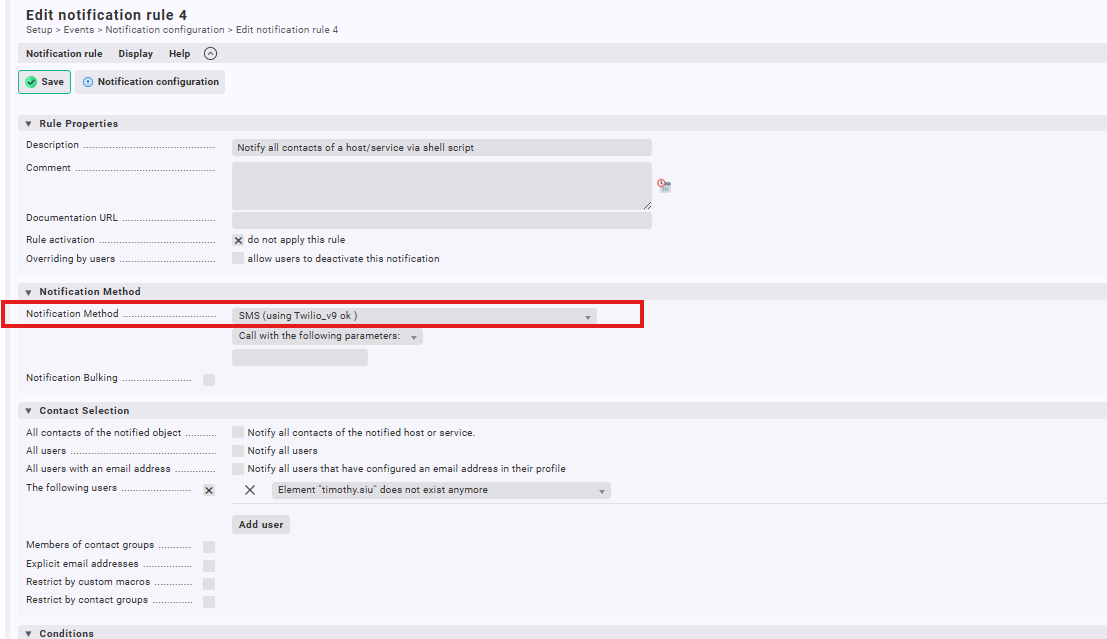

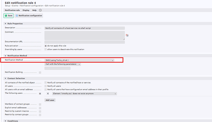

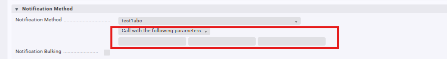

I have a further question, I am trying to setup voice call notification, so we can receive phone call when the monitoring device triggers the alert. But we don’t know how does the checkmk transfer the alert from words to voice, what should we put in the python script and what parameter should the script pass to checkmk ? There is drop down for “call with following parameter “, how can I make use of it ? Please help. Thanks
You probably don’t need the parameters to the script because all information is passed to the script via environment variables. The most important ones are explained in the documentation: Notification basics
