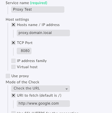

The options should look like this.
-I proxy.domain.local -p 8080 -u 'http://www.google.com'
The “-I” is not needed if the proxy host is the last argument. The generated config line has the proxy name at the end without the “-I” and it is working.
This is how it looks inside the setup.
Result: '-u' 'http://www.google.com' '-4' '--sni' '-p' '8080' 'proxy.domain.local'
