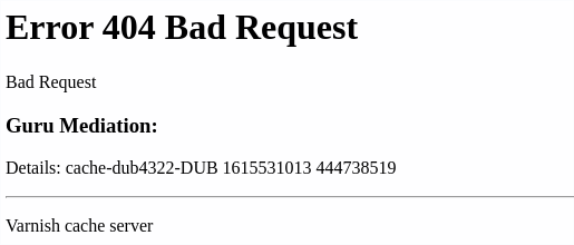

I am trying to set a http check. It always gives back 200 OK in server response, even if I have a 404. On my check_mk server:
# ./check_http --expect=200 --ssl my.host.com
HTTP OK: Status line output matched "200" - 75414 bytes in 0.268 second response time |time=0.267687s;;;0.000000;10.000000 size=75414B;;;0
The active http check in WATO behaves the same of course, at the same time the web host gives 404:
$ curl https://my.host.com
<?xml version="1.0" encoding="utf-8"?>
<!DOCTYPE html PUBLIC "-//W3C//DTD XHTML 1.0 Strict//EN"
 "http://www.w3.org/TR/xhtml1/DTD/xhtml1-strict.dtd">
<html>
  <head>
    <title>404 Bad Request</title>
  </head>
  <body>
    <h1>Error 404 Bad Request</h1>
    <p>Bad Request</p>
    <h3>Guru Mediation:</h3>
    <p>Details: cache-hhn4059-HHN 1615531030 2040292555</p>
    <hr>
    <p>Varnish cache server</p>
  </body>
</html>
And here is a screen shot:
Screenshot from 2021-03-12 07-37-47
How can I get the http check to work?
Thanks a lot.

I see the 404:
* TLSv1.3 (IN), TLS handshake, Newsession Ticket (4):
* Connection state changed (MAX_CONCURRENT_STREAMS == 100)!
< HTTP/2 404
< server: Varnish
< retry-after: 0
< content-type: text/html; charset=utf-8
But which parameters do I need to make the http_check sees it as well. I tried different things but the check gives always 200 OK.
