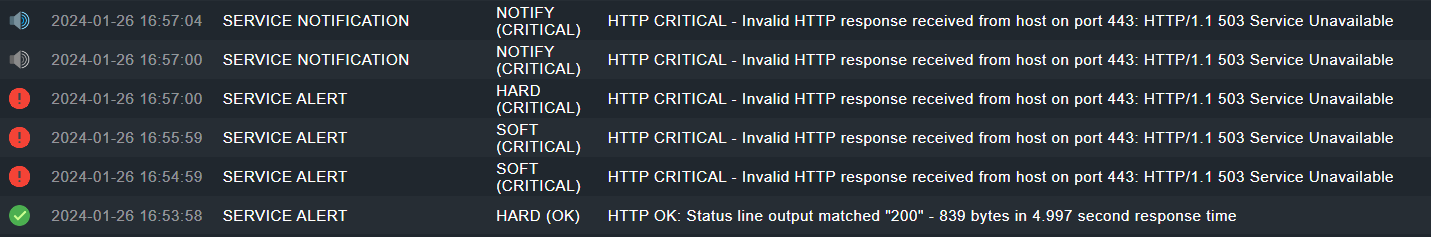

My settings:
  • Maximum number of check attempts for service: 3, Based on Services HTTPS .*
  • Notify when critical
  • Check: Just a HTTPS URI, nothing fancy
  • Service normal /retry check interval: 60/60s
When I trigger an 503 error on the website that I monitor, I get directly after the first check a notification.
When I trigger a 504 error on that same website, I get a notification after 3 check attempts.
Why is 503 that special in CheckMK ?

Here you see its working as i expect:
But when i try it a few minutes later:

[1706610740] SERVICE NOTIFICATION: check-mk-notify;student-20.XXXXX;HTTPS Homepage;CRITICAL;check-mk-notify;HTTP CRITICAL - Invalid HTTP response received from host on port 443: HTTP/1.1 503 Service Unavailable;;
[1706610745] EXTERNAL COMMAND: LOG;SERVICE NOTIFICATION: dave.greebe;student-20.XXXXX;HTTPS Homepage;CRITICAL;check_mk_telegram-notify.sh;HTTP CRITICAL - Invalid HTTP response received from host on port 443: HTTP/1.1 503 Service Unavailable
[1706610745] SERVICE NOTIFICATION: dave.greebe;student-20.XXXXX;HTTPS Homepage;CRITICAL;check_mk_telegram-notify.sh;HTTP CRITICAL - Invalid HTTP response received from host on port 443: HTTP/1.1 503 Service Unavailable
[1706610745] EXTERNAL COMMAND: LOG;SERVICE NOTIFICATION RESULT: dave.greebe;student-20.XXXXX;HTTPS Homepage;OK;check_mk_telegram-notify.sh;{"ok":tru....}

After a few days letting this go I tested it again;
Periodic Notifications: 5 minutes
Check Attempts: 3
Check interval: 60s/60s
Trigger a crit on website:
9:00: OK
9:01: CRIT
9:02: CRIT
9:03: CRIT
9:03: Notification
9:08: Notification
9:13: Notification
9:18: Notification
9:20: OK → but site back
When I check the page, I see that my Service Notification Number is 4.
That should not be correct because it should be reset after service is OK.
I check this number a couple of times but its now 30 minutes past and still the Service Notification Number = 4
I reported this as a bug to feedback@checkmk.com
Solution found, based on the info in this post;
I had my rule “Notified events for services” set to “Service goes into critical state”
When my service goes to critical and after a few checks to OK, the CMC is not notified about this so the SERVICENOTIFICATIONNUMBER was still at x and was never reset.
I updated the rule “Notified events for services” and added “Service goes into OK state”
I triggered an CRIT and after a few times service was OK and now the SERVICENOTIFICATIONNUMBER was reset to 1.
Triggered an error again and now it started 3 check attempts and then notification.
Finally solved my issue.
