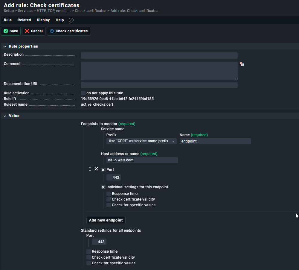

The “check certificates” check doesn’t seem to support proxies though - at least not in the 2.4.0p26 (which is the latest 2.4.0 version as far as i’m aware).
Yes you right. In 2.4 the only option IMHO is the old http check. Starting from 2.5 check cert should have this option, where httpv2 still doesn’t
