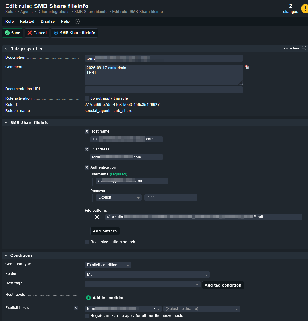

Hello Andreas,
For this problem, I found a plugin or a rule that looks like it might work.
I’ve set it up, but it’s not working for me.
Is there a way to fix this, or is it not possible?
SMB Share fileinfo
SetupAgentsOther integrations[SMB Share fileinfo](javascript:window.location.reload(false))
but it doesn’t return any information; it gives me an error.
error:
[special_smb_share] Agent exited with code 1: Invalid pattern //tor.com/MD-TP/C_DC/CNB_D/*.pdf. Pattern has to consist of host name, share and file matching patternCRIT
Regards,
Vix

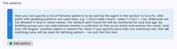

The inline help sometimes might be useful, you can active the inline help at the upper menu under the Help topic.
So the SMB protocol need to have windows style backslashes instead the slashes, at least worth to check that.
