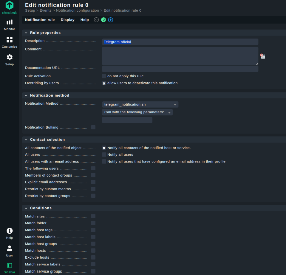

I have created the new notification as you can see in the screenshot.

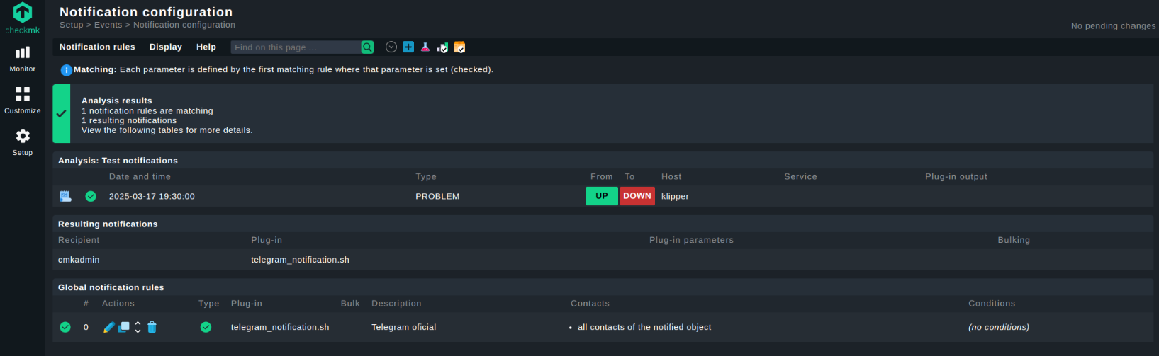

Now I hit “test notifications” and get this:
I have also tried from “fake check results” in several services, and the script does not run either.

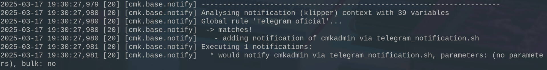

notify.log:
What else could I review?

Here you also only see a test of the notification rules. How does it look like with a real notification? You said that you tried a fake check result and this was also not working. With fake check result you need to consider the needed checks until you reach a hard state for the notification.
All the other settings should be correct.
Thanks for the reply. Now the script is running with real events, so I probably still don’t quite understand how checkmk works.
