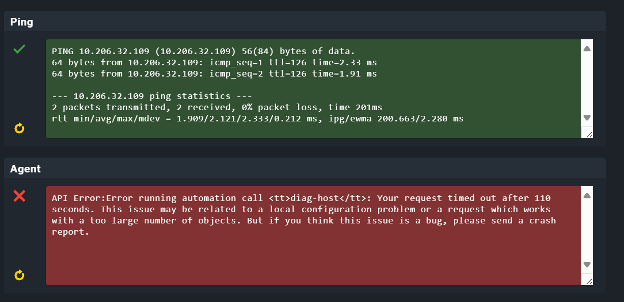

I have installed checkmk agent in windows server, but in UI console I am getting the below error
I have installed checkmk agent in windows server, but in UI console I am getting the below error.
Agent
API Error:Error running automation call diag-host: Your request timed out after 110 seconds. This issue may be related to a local configuration problem or a request which works with a too large number of objects. But if you think this issue is a bug, please send a crash report.
Verification done
targeted machine pinging from checkmk site
telnet is working fine for 6556
checkmk version verified
Windows firewall id off.
Hi Anushiya, welcome to the community.
Looks like , that also a API Call is also configured to this server. Please check this out.
RG, Christian
