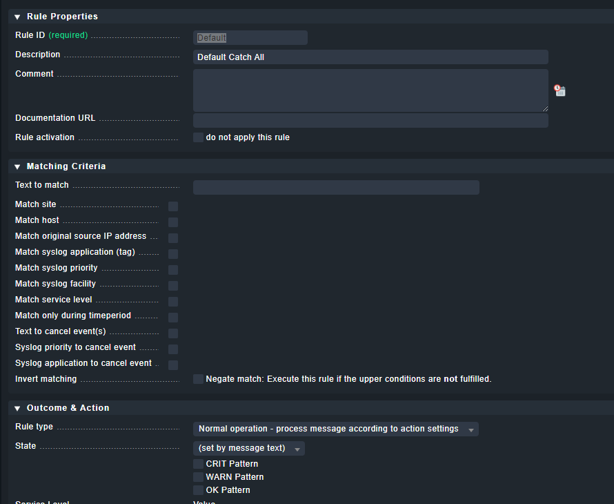

Then events make it to Checkmk and the rule is off. Maybe you want to share a screenshot of your rule.

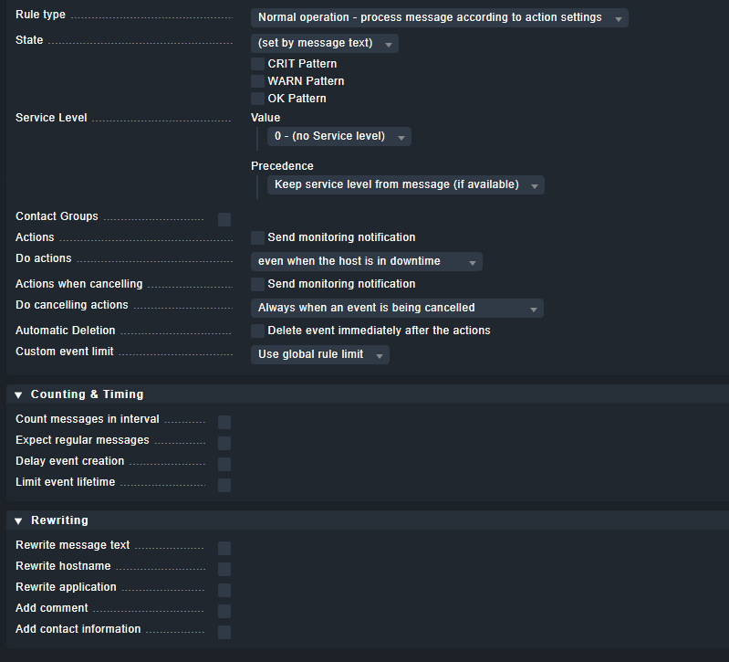

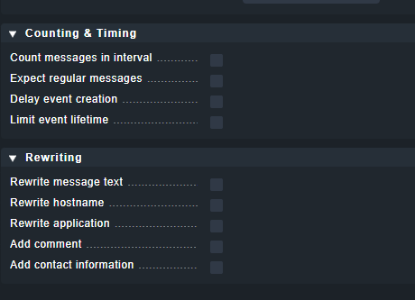

Sure see attached 2 screen shots. Thank you
Hi @zoldy2000,
there is no text to match, you need to enter . * if you want to match all events.
Okay I changed that to CRIT in the drop down since I only want critical. Documentation said to create a rule and leave all the default values to catch all. Hopefully this finally resolves it thank you so much.
I am still not getting any events. This is the current rule.

Sorry is that something different than I just posted? That is my rule.
