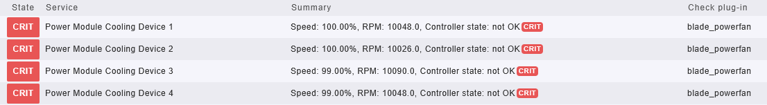

The issue highlighted here is the check for blade_powerfan is returning as Critical for Power Module Cooling device in an older IBM Chassis.
Power Module Cooling Device 1 Speed: 59.00%, RPM: 5973.0, Controller state: not OK(!!)
Power Module Cooling Device 2 Speed: 59.00%, RPM: 5888.0, Controller state: not OK(!!)
Power Module Cooling Device 3 Speed: 59.00%, RPM: 5888.0, Controller state: not OK(!!)
Power Module Cooling Device 4 Speed: 60.00%, RPM: 5994.0, Controller state: not OK(!!)

I can query it via snmpv3 and get what looks like an ‘operational’ response.
.1.3.6.1.4.1.2.3.51.2.2.6.1.1.7.1 0
.1.3.6.1.4.1.2.3.51.2.2.6.1.1.7.2 0
.1.3.6.1.4.1.2.3.51.2.2.6.1.1.7.3 0
.1.3.6.1.4.1.2.3.51.2.2.6.1.1.7.4 0
Since this is an inventoried check I can’t override the status so have instead disabled the blade_powerfan for several chassis in the short term.
Is this a check maintained by CheckMK or something from Nagios? Any thoughts on a way to correct it or should I leave it disabled?

As a short term fix, I updated the values in the cmk code locally, cleared the pycache and did an omd restart.
    yield Result(
        state=State.OK if fan.ctrlstate == "0" else State.CRIT,
        notice=f"Controller state: {'' if fan.ctrlstate == '0' else 'not '} OK",
I hope these older IBMs get phased out in the near future so it’s not the end of the world but I did want to bring it to someone’s attention.
