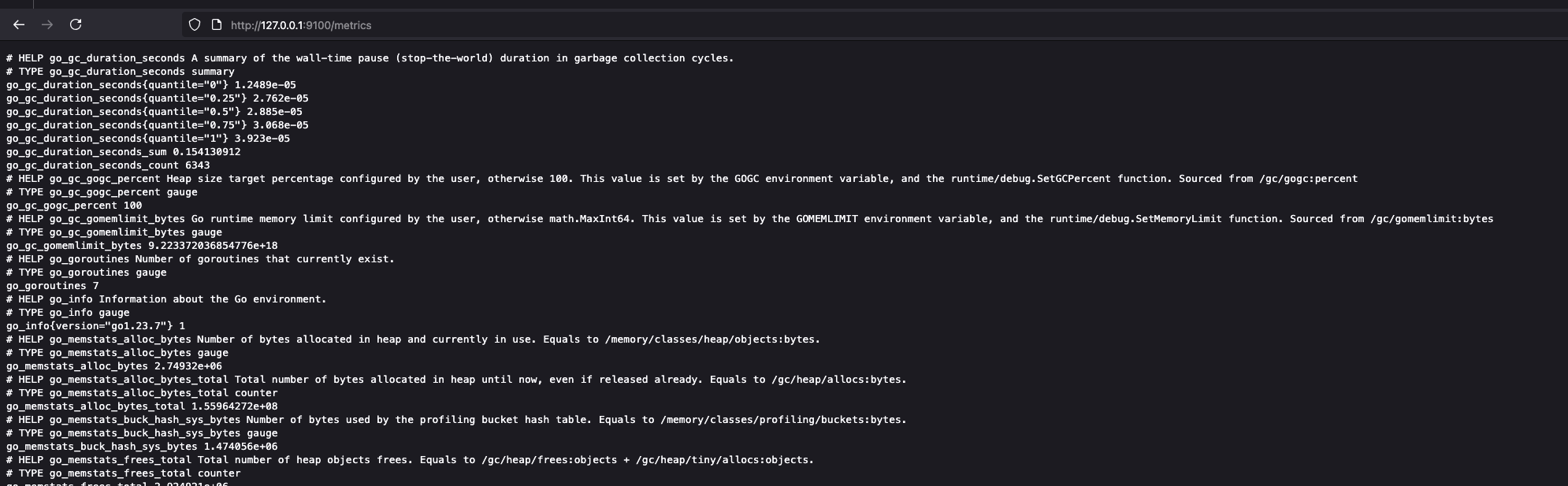

Have you checked if this: https://10.. .*:9100/metrics/ even works when you try to open in a browser ?
Also, is it really https or http ?
hi, thank you for responding
its http , yes i have tried to curl it from the browser and its working fine but when i try to apply the url checkmk it seems that the checkmk is trying to pull from a prometheus server Max retries exceeded with url: /10...*:9100/metrics/api/v1/query?query=up (Caused by NameResolutionError(“<urllib3.connection.HTTPConnection

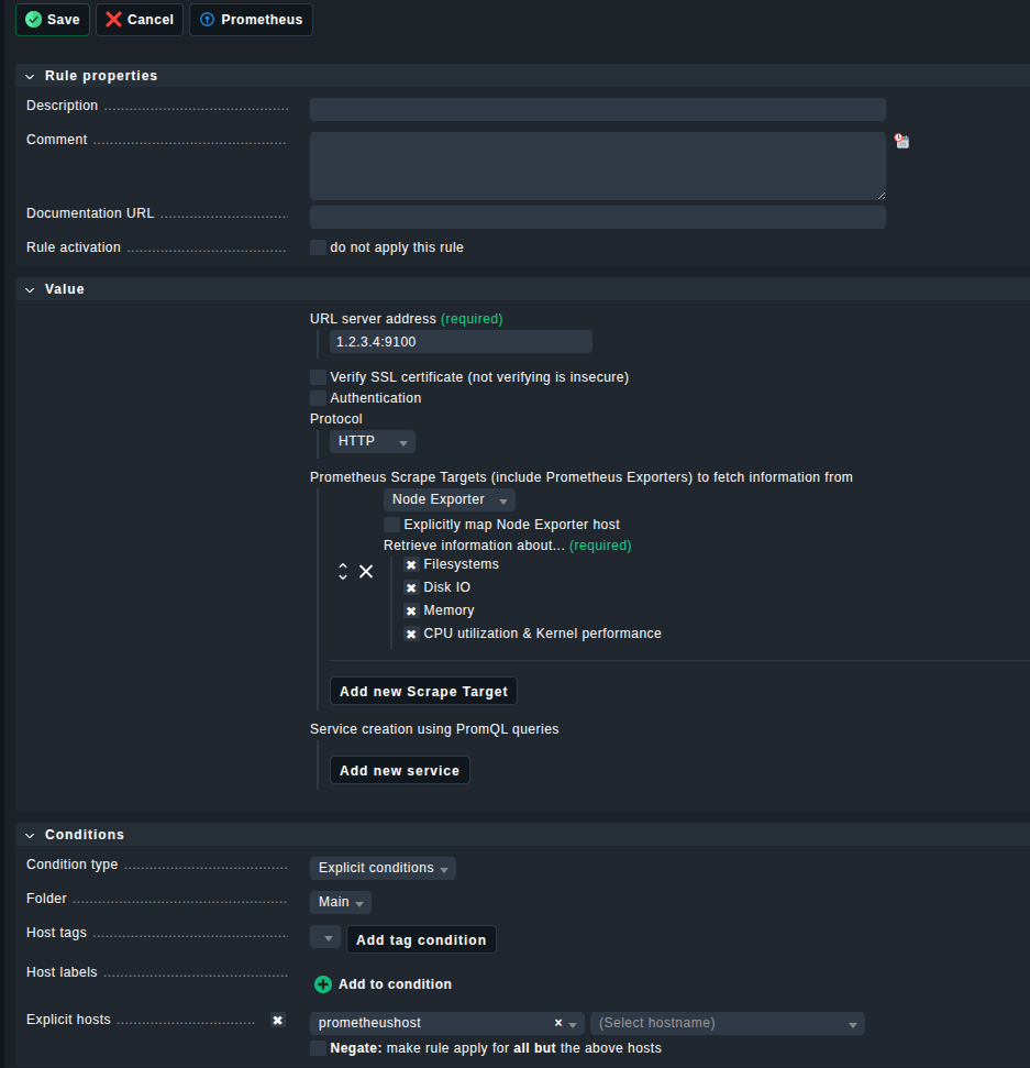

Have you defined like this?

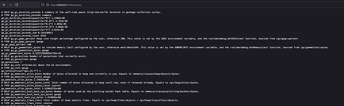

yes find the below pics. in my below senario could i fetch directly from node_exporter or i need prom server? also one more question… from node_exp in checkmk are the only available metrics are mentioned?

keep in mind i am using three systems: 1 where the checkmk & prom server is installed and the rest systems are targets/client.
