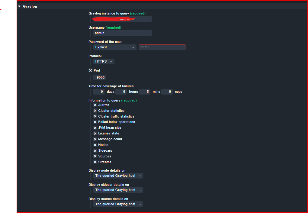

I am trying to integrate Graylog into checkmk monitoring but I am not able to discover any services.
What am I missing? can someone help me? should I need to enable any options inside Graylog to enable access from checkmk?
Please find the rule-created gray log.
Thank you,
I would double-check the permissions of the user used, although that seems like it is a high-privilege user (which is a bad idea for production but okay-ish for testing).
Also, maybe Checkmk cannot verify the certificate of the Graylog server?
Both wild guesses, but maybe they point you into the right direction.
