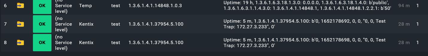

I would actually like to avoid traps, since it can be needed at times, I am currently familiarizing myself with the event console. So far everything works, I receive the traps from our Kentix or MessPC Temp sensors. Here there is the possibility to make a pull, but for testing/practice I play here temporarily with traps.
Now I’m still a bit inexperienced when it comes to the traps, unfortunately I don’t quite understand how I should interpret the data (make services out of it, etc.), the manual indicates it requires many rules? There are even checks for Kentix and Messpc, at least I can find some in the catalog and documentation of the check plugins
Now I have uptime and a list of numbers in my event console, how can I read the temperatures or the data from other applications, it probably has to do with translateing the OID?

First, ensure your site is configured to accept incoming traps. Log onto the site via SSH and run omd config. Drill down to Addins and ensure MKEVENTD and MKEVENTD_SNMPTRAP options are both on.
Create a single event console rule and call it something like “SNMP_Unhandled” as a catch-all for any SNMP traps that your system might receive and that are not handled elsewhere. Later, when you create more meaningful EC rules, keep this one at the bottom of the list and never delete it. In the Matching Criteria section, match syslog facility: snmptrap. In the Outcomes & Actions section, make the rule type “Normal operation - process message according to action settings”; State: UNKNOWN.
Don’t worry about uploading MIB files at this stage but in Event Console Settings, SNMP Traps section, change the Translate SNMP traps option to “Translate SNMP traps using the available MIBs”. You will also need to declare the SNMP credentials (aka community string) here.
Save the changes and try sending a trap to your Check_MK server. Navigate to Recent Event History and see if anything has been captured. What you see will give you a good insight as to what is being received, how it is translated and how to make sense of the data.
