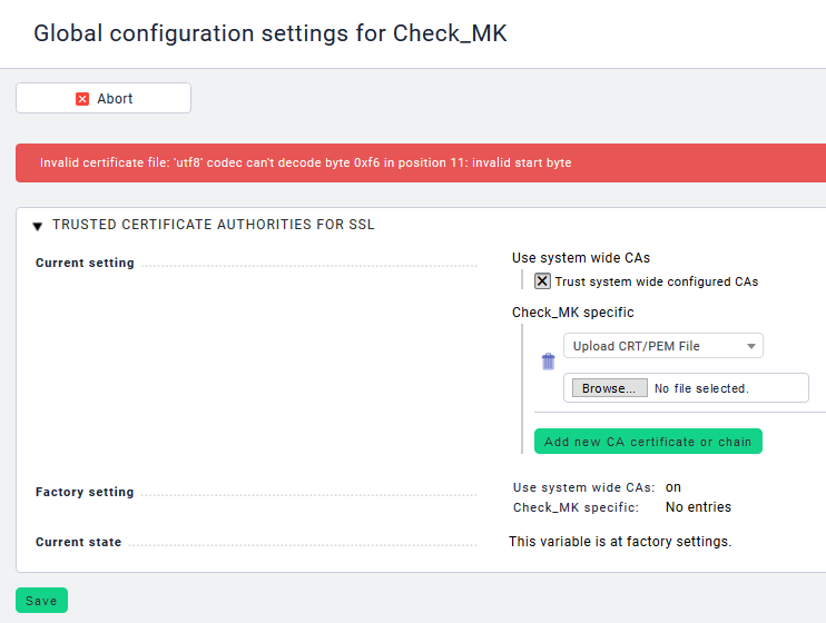

Invalid certificate file: 'utf8' codec can't decode byte 0xf6 in position 11: invalid start byte
Hi everyone! I got a weird error I can not seem to get rid of.
When trying to upload a .pem file into the Global Settings section Trusted certificate authorities for SSL I get the following error:
I double checked the certificate file and it works fine everywhere else. Both copy/pasting the contents and uploading the whole file do not work.

Alright, so now I got the chance to check the situation in more depth, but I can’t fix this issue.
What I have done so far:
  • Created a new CSR with the -utf8 Switch, as I have the German Umlaut “ö” in the certificate
  • Uploaded the procured certificate along with the key and the CA certificate to the webconf and enabled the certificate for the web interface
  • Imported the certificate into the OS CA certificate store (checkmk Appliance Debian 9)
The outcome is unchanged: Neither can I upload the CA certificate or the certificate itself to the checkmk web interface (not webconf, that works), nor can I connect to the server via HTTPS (for e.g. BI aggregation check etc).
I am currently investigating the possibility that the CA certificate itself causes this problem, although the person responsible for the CA told me, that there were no issues with the CA certificate with any other use case. Maybe this is something checkmk can not handle properly (yet)?
