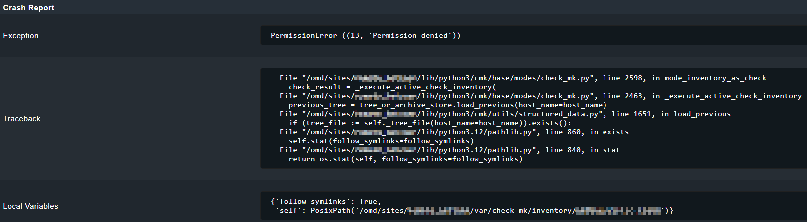

I have a satellite server in my checkMK instance, which also manages several hosts. The problem with this one is that the inventory check does not work.
I have the plugin used for this from the plugin store and it also works without any problems on the other instance. The crash report reports problems with the authorization, but I cant find where they occur. The problem is probably relatively easy to fix, but I cant get it to work.
The crash occurs for each individual host under this specific satellite host. I dont have the problem under the “main”-site, despite identical rights on the plugin.

This is not a problem with the plugin.
Please check the rights inside your CheckMK site.
It looks like there are some messed rights inside the filesystem.
The path you blurred is not accessible for the CheckMK.
