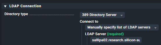

In general we have FreeIPA configured :

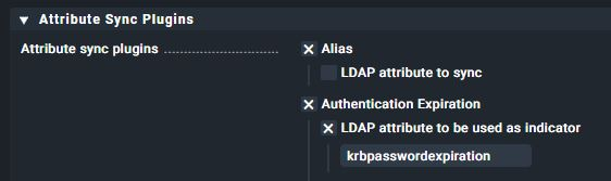

and also I had this setting before (this was configured out-of-the-box):
1st I tried mike1098 suggestion:
but this resulted in:
“The “Authentication Expiration” attribute (pwdlastset) could not be fetched from the LDAP server …”
so I disabled this completely now:
and now it’s silent. The log message doesn’t appear anymore.

The user clearly shows they are using 389 directory server so I guess that’s a no :slight_smile:
