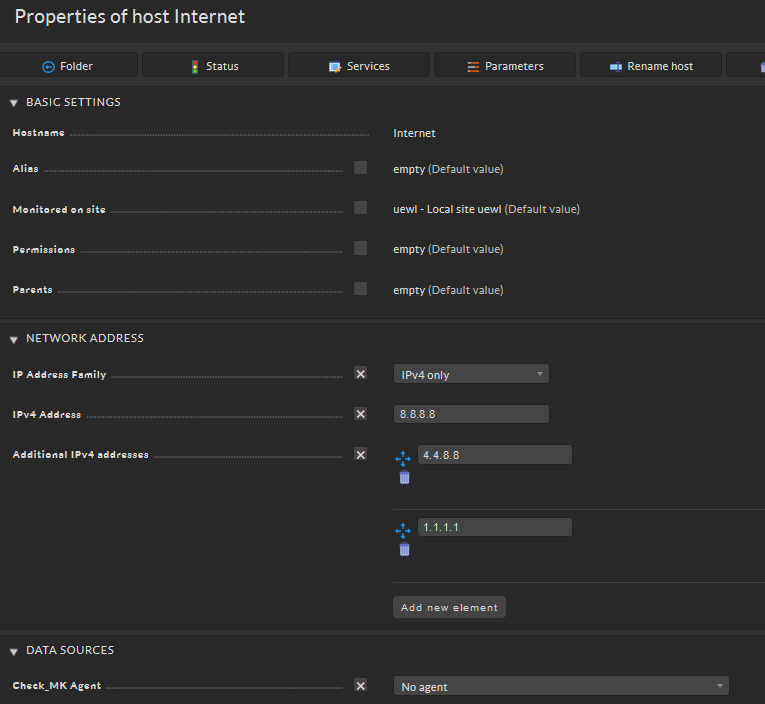

My host settings are like the totorial:

I tried it again and now I saw in WATO this:
That is looking good!
But the result is still the same:
:scream: :flushed:
