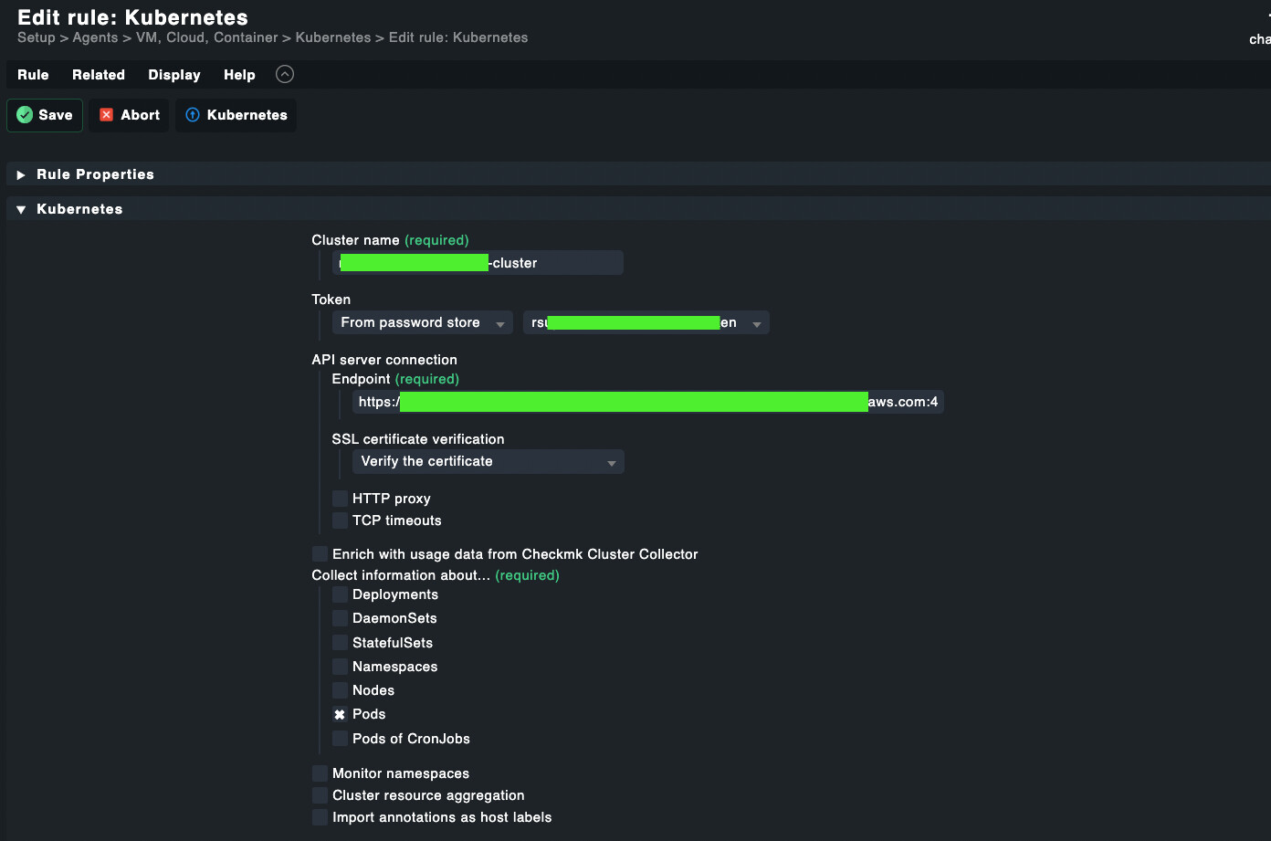

However this is the my UI part , where after I add endpoint im unsure regarding generating a token. I have tried different things but I wasn’t able to get metrics for K8s
Could you please advise which steps should I take, and how could I debug my issue.

Thank you I made some progress.
Generate Certificate and Token , added them to checkMK.
Now my Problem is once I create a host , how do I link that host to my K8s ?
This is my Host:
How to Link this host to my K8s
After I activate everything on site nothing happens
In the context of the Kubernetes rule, set a hostname “my-k8s-cluster”
This way, the rule is applied to that specific host and the host then knows it has to fetch the data from the K8s API
