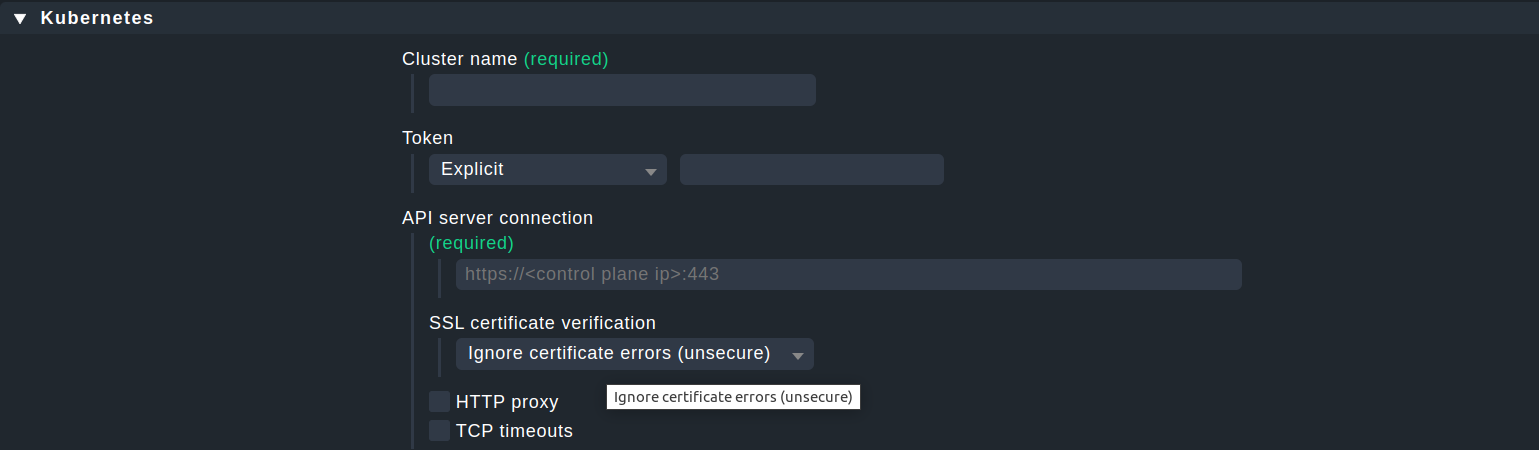

This is good, because it means there is no connection problem.
For test purposes, you can just tell the Checkmk to ignore certificate errors.
You can also further try to debug it yourself using this article:
https://checkmk.atlassian.net/wiki/spaces/KB/pages/9470436/Debugging+the+Kubernetes+-+k8s+special+agent#DebuggingtheKubernetes-k8sspecialagent-DebuggingK8sspecialagent
Running the command in verbose with debug helped me often to trace the source of the issu
