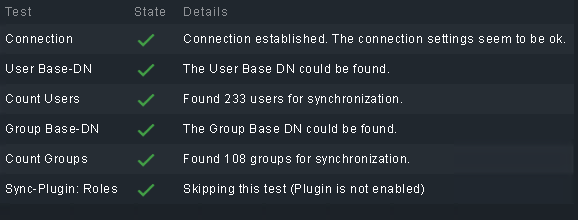

Recently I have restored the checkmk backup from a CentOS 8 stream VM to a physical server. The OS on the physical server is Ubuntu 20.04 LTS version and then upgraded checkmk version from 2.0 to 2.1 OP5 CRE
After that configured LDAP settings such that we login with our AD credentials to checkmk, now the strange part is LDAP is synced successfully but I am unable to login with LDAP credentials. It says Invalid login.

Yeah I did that, and the strange thing is my name is there in the sync users in web.log but when I try to login only with my name it says invalid credentials and this come in web.log
2022-07-15 11:32:52,425 [30] [cmk.web.auth 1222745] Login failed for username: abcd (existing: No, locked: N/A, failed logins until locked: N/A), client: xx.xx.xx.xx
And when I try with some other user, I am able to login in the checkmk…so now I am confused…that why for my user its giving the problem although its present in sync users…

We found the issue, actually my user profile was created earlier in checkmk with htpasswd , now after AD integration, I deleted my user profile in checkmk and tried to login with AD password and it was giving invalid login because it was still taking the connection" htpasswd" .
After changing the connection from htpasswd to ldap in my user profile , it worked.
