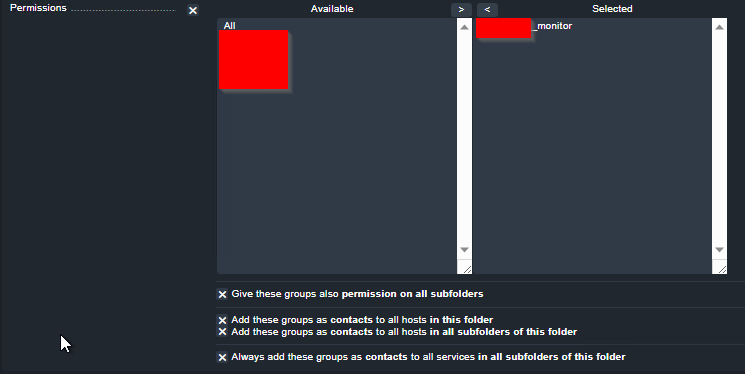

Hi Robin, I created a contact group on the central server with the same name as the AD group, Then set contact group on the folder that holds the systems on the remote site with these options.
Then pushed these changes to remote site. After that, I can see on the remote server that the AD accounts are found as members of that group and I can log on with an AD account on the remote server GUI, but don’t see any devices/services.
When I set the option “Only show hosts and services the user is a contact for” in the user settings on the remote server, do I see the hosts/services. But that option is overwritten during the next update from the central server. I could not find an option to set that option on the contact group on the central server?

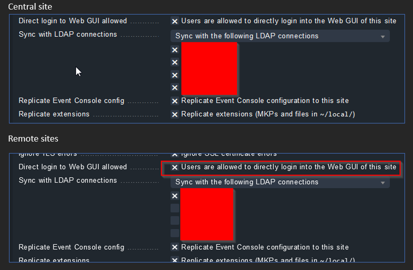

First you create a LDAP/AD connection for your specific remote site using your local AD servers.
Then In your distributed monitoring you target that specific connection for LDAP sync

Hi Anders, I disabled the option to create users at login and only use a contact group with the same name as the AD security group name. That contact group has permission set on the folder whee all systems for that site are stored. The AD domains are different for all sites.

I think we fixed the issue, it turned out that the distributed monitoring for the remote sites only synched with their local LDAP servers. But when we checked the config for the central site, we saw that not all LDAP entries were selected.
After selecting all LDAP entries and pushing the config, we saw the remote LDAP users showing up in user mgmt on the central site. Stupid misconfiguration on our end.

Hi guardian,
We have different domains on the central and remote sites. The LDAP config is pushed from the central site to the remote sites via distributed monitoring. The central server has LDAP access to all remote domains.
In distributed monitoring, we checked the sync to all LDAP connections
On the remote sites, we only selected the LDAP connection for that site
We enabled the option to allow direct login to the web UI of the remote site on all sites.
We can see all LDAP users on the central site, set permssions or contact groups on the central site and push them to the relevant remote sites.
Local site admins can access the CheckMK web UI directly and they only see the systems that are managed on that site (if they have permissions)

Hi guardian,
Quick addition, if your central server cannot connect to the remote LDAP servers then the above will not work.
The central server needs the LDAP access or it will not see the users (and then you can’t push permissions for those users to the remote sites)
